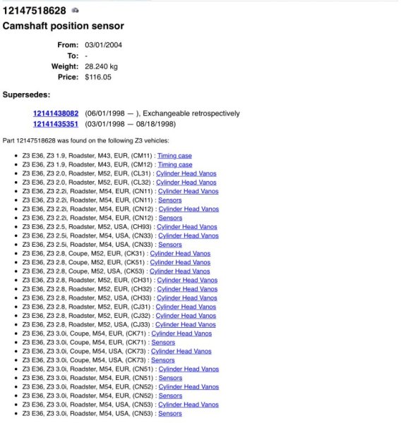

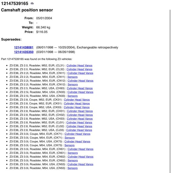

Just got this from Soper’s BMW…
Regarding the camshaft sensor, now there are 2 catalogued for the vehicle,but unfortunately it doesn't state which is inlet or exhaust.
They do look different, one is cylindrical and has a lead attached to it, the other is more oval in design and doesn't have an attached lead.
I'll give you the part numbers of both so you can look on line to try an identify the one you need.
12147539165 ( lead attached ) now unfortunately this is on long term back order, with no date as to when it will be available.
Price wise, if l could supply you one, you would be looking at approximately £118 inc. discount and VAT.
12147518628 ( no lead ) this one is available from UK stock and would cost you £109.10 inc. discount and VAT, taking 2 days to source.
can anyone tell me which one I need?
