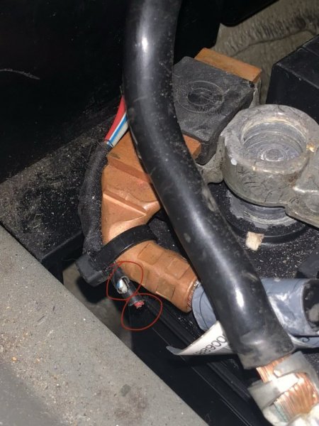

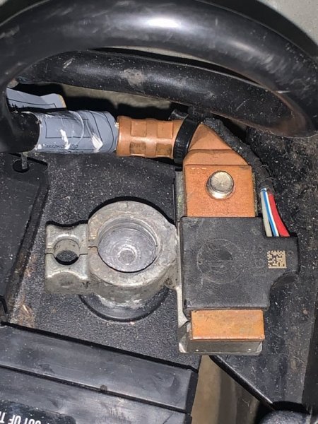

So today I discovered two new things:
1. The battery ground cable is not all the way on, and is missing hardware
2. There are THREE wires coming off the ground which are totally cut (a solid red, solid gray and a white/blue wire). They look like they are going into some BMW clip on the ground, so I’m assuming they are factory wires.

That's not the factory negative terminal. While it has BMW on it, its off another car, so those extra wires are just not part of the Z3 setup.

The bolt being missing out of the clamp won't help, and it also looks like you've got a case of "previous owner blues" coming on. Not very constructive, I know, but seeing cut wires and missing bits probably means there'll be more hidden horrors. Patience and a multimeter will be your friends.
