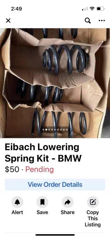

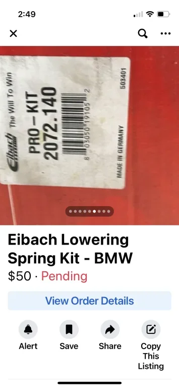

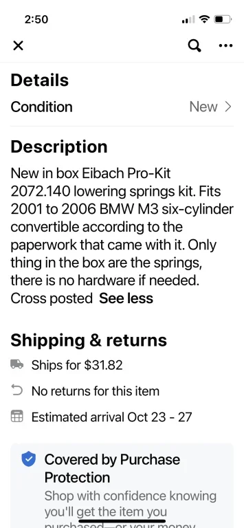

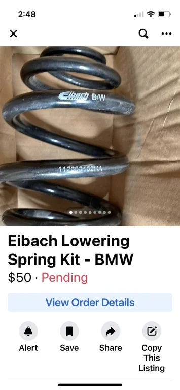

Good afternoon. I have been on the lookout for lowering springs and found a nice deal on a new set of Eibach 2072.140 on Facebook marketplace. They are intended for a 2001-2006 M3.
Could these springs work on a 1997 2.8 Z3? My research shows the Eibach 2060.140 is the model number intended for my car. I figured it’s a long shot but the deal was too good to pass up. If not, I will try and sell or trade.

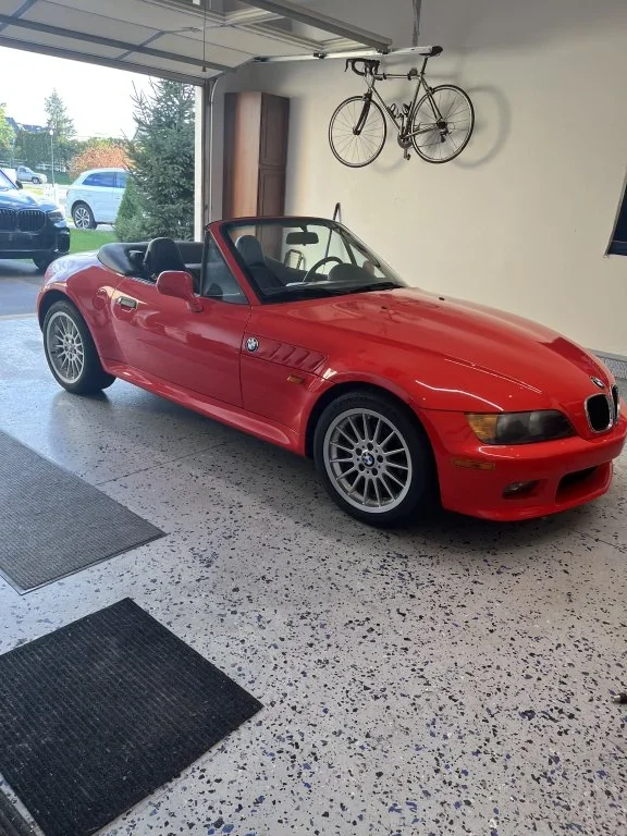

Thanks as400. Your car has the look I’m after. Beautifully done.

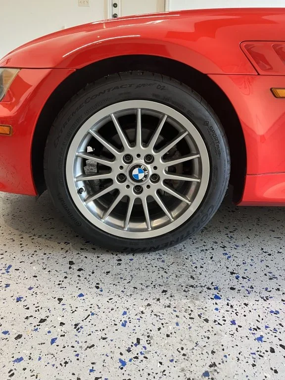

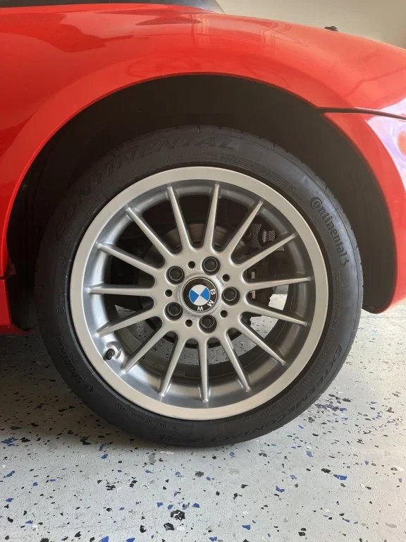

I’m sure someone will chime in and let me know if the springs I bought will work. I recently refurbished a set of staggered 32’s and had them powder coated. I hoped the move from 16’s to 17’s would help the wheel gap issue. It didn’t. I love the new rims and rubber but looking to go a little lower.

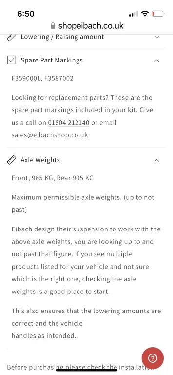

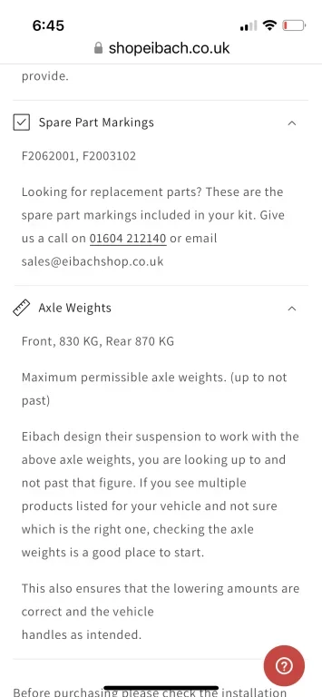

Thanks. I will give them a call and see what they say. I found this info on the link you shared. They are deigned for different axle weights. They are close though.

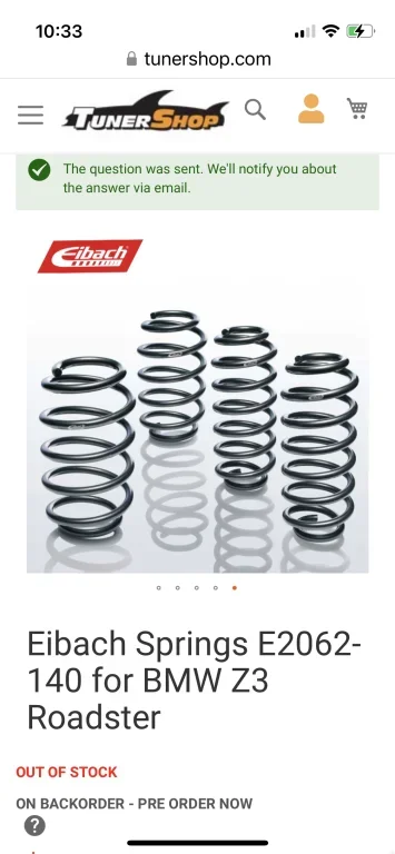

This is interesting. I spoke to Eibach USA and the rep confirmed that these will not work. I’m not surprised. It was a $80 gamble and they will go on eBay when they arrive later today.
Most unusual, Eibach USA does not offer a e2062-140 or any type of ready-made kit for Z3 2.8 on their website. He recommended Tuner Shop as a U.S. online site for e2062-104 but they are backordered. I emailed them for a timeline. Let’s see what they say.
The hunt continues….
