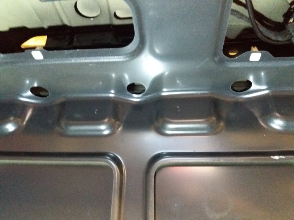

To remove the light unit , raise the boot lid and look for three round holes in a line across the lid.
Remove the 2 plastic panels in the lid (2 screws in each) to allow access to the wiring connector, not possible to disconnect it without.
