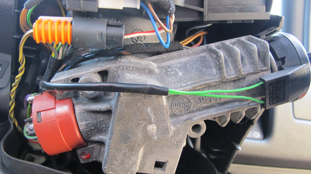

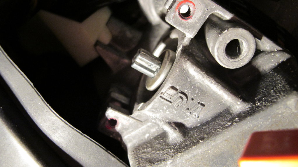

With regard to ignition lock comments this has happened on mine twice - first one was with engine running and unable to switch off.
So far I have been unable to get the barrel out using the pin method previously mentioned. Suspect whatever has broken off is preventing removal.
Fortunately I have been able to re-enage it by removing the red ignition switch from the bottom of the cylinder and turning the centre shaft and ignition key. You can also stop/start the car by inserting a flat blade into the switch and turning ( the key needs to be in the barrel).
