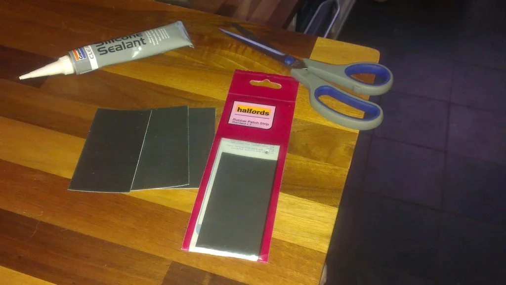

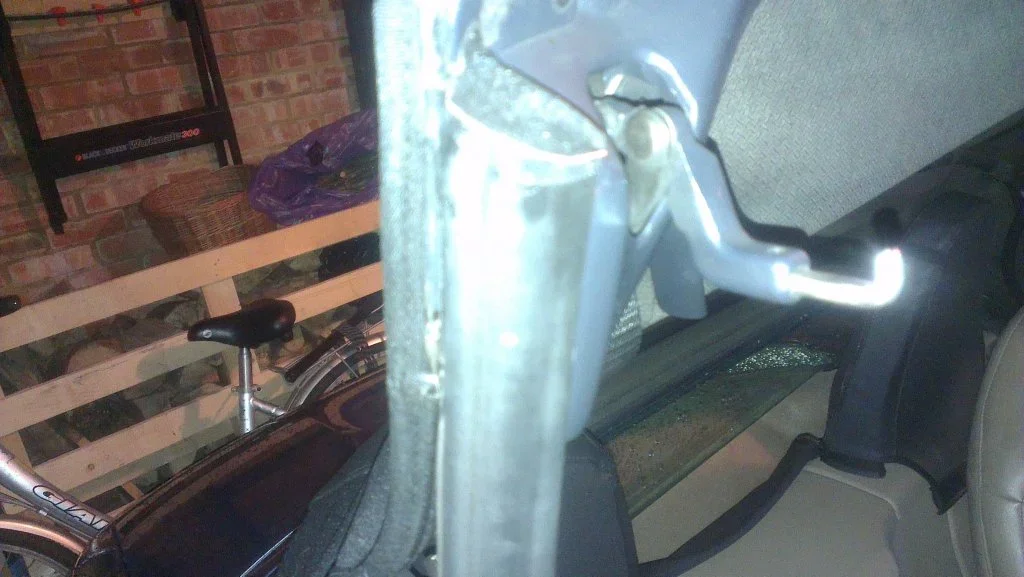

here is my "first fix" on the roof problem
will let you guys know how it works..
I spread an even coat of silicone gasket/adhesive onto the a frame where the hood meets it and then took some puncture repair sheets cut them to size and glued them with the same stuff to the end of the seals on the hood..
they are quite thin but I have enough to add more if it doesn't work first go..
p.s it look a lot messier in the pics than it actually is...blinkin flash..
have also tightened the roof catches by the smallest amount possible,hopefully that will help too,it looks like its never been done on this car so may be a fairly effective part of the process..

success!..(at the moment at least)
have just been out for a drive and to the local hand car wash, sat in the car whilst they gave it the beans with the power spray and there was not a drop coming in...
lets hope we are good for the rest of the winter..I think I am going to redo this again in the summer with some better materials as I feel although this works and looks ok, with some time and effort in dry conditions I could get a "factory finish",but the fix works, as always you learn a lot the first time you do something and have seen some ways to improve the look of it for the next time it needs doing...(which i'm sure it will!)

hardtop I found that thread on my internet travels and it was very useful in diagnosing and offering a solution for the issue..
I have now gone 2 days with the interior as dry as a bone, the problem was the "rubber bung" in the A frame where the top meets the window, applied some sealant type stuff and also added a patch of puncture repair kit to the ends of the seals on the top itself...and tightened the latches also..
went off to my local carwash place and asked them to give it the beans with the pressure washer whilst I was sat in the car...not a drop!
cost £7 and about 15 mins to do and 3 hours for the glue to dry...my neighbour let me use her garage for the afternoon...so thanks are due to doreen at number 2!
