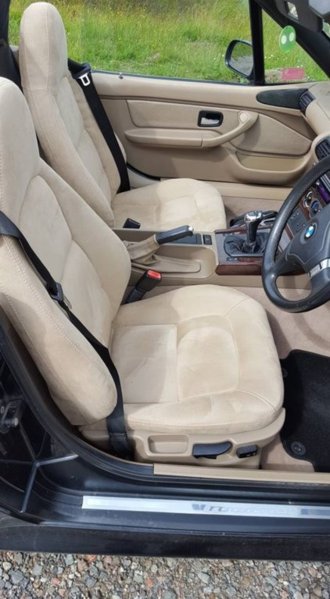

Previous owner spent £1k on re-upholtstering in alcantara.

Nice looking Zed you must be soooo chuffed the seats looks awesome :thumbsup:
WOW best clobber only for sitting on those seats. Re the shockers, you'll likely find that they're well past their best, especially the rears. My best advice would be to change all four corners springs and shocks.
