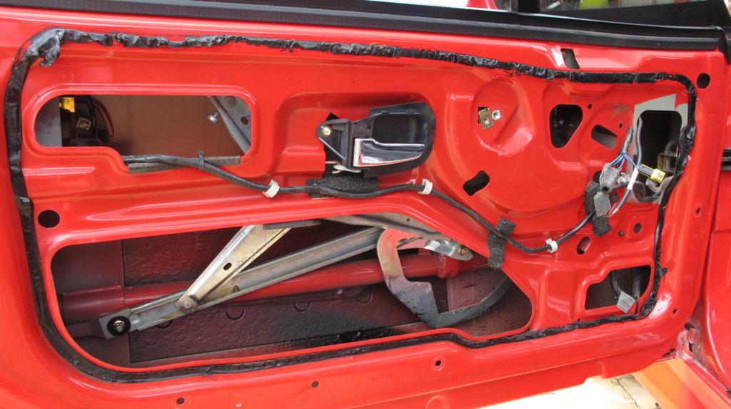

The wet floor saga continues!:D Since the floor is dripping wet both in front and behind the cross member that divides it, it seems reasonable to me that rain coming from behind the door trim panel is the most likely source. So I took the passenger door panel off and look what I found. Not only is there all that duct tape, but I see the membrane is cracked quite badly in several places. Someone has obviously been here before trying to fix the same problem.
It started getting dark so further investigation was stalled. How is the membrane fixed to the door? Is it glued on? Can I buy a new one? What should I do to keep the water inside the door from where it can escape through the drain holes?

I doubt that is the source of wet floor. It' more likely a clogged drain hole in the A pillar or a seen better days door seal at the bottom.

They are fixed on with butyl sealant but thick layer of Black Silicone looks similar.
Ours was leaking through a small area of the sealant where it wasn't fixed properly and when we sprayed the hose on the window the water could be seen dripping from behind the door cards. strange but true.
Our carpets were wet through and caused our DSC lights to be on but since sealing the membrane no leaks and dry carpet. Ultimately I guess the window seals have lost flexibility .

Yes it has been DSC lights that prompted this saga. The sensors on the floor were swimming in a lake. So it's gratifying Brian that sealing the door membrane fixed your leak. You say the window seals have lost flexibility, but in fact it is virtually impossible to prevent water getting inside the door even from new. That's why all car doors have drain holes.
I was about to say that and is surprising how much water runs out of them. I guess the drips off the bottom of the window glass supprt and a few drips find their way onto the winder linkage and splash onto the membrane and eventually find the weak spot in the membrane.
This is where the gap was in ours so some silicone has cured it.

I am sorting out the doors on our Z3. Do not understimate the issues a torn or badly sealed membrane can cause when it rains, especially in driving rain. Pouring water along the bottom window seal should show if you have issues with your membrane(s) or blocked door drains. Open your door first and pour from the outside!
Replacement membranes are roughly £70 from Sopers (Lincoln) : Part numbers are
LHS: 5148 8410037
RHS: 5148 8410037
Source:
https://www.realoem.com/bmw/enUS/showparts?id=CH32-EUR-09-1999-Z3-BMW-Z3_28&diagId=51_2351 (Z3, 1999, 2.8i)
The old ones are held on by a butyl mastic with a thin wire/cord inside which helps remove it from the door when you pull the wire/cord. Makes sure the surfaces are clean before you reseal. I doubled/folded the tape I used over to make a thicker bead as it was "flat" buytl tape. You can buy tape that is more of a bead/rope shape though if you search online.
Buytl tape: https://www.amazon.co.uk/s?k=canopus+butyl&crid=X59ORPGTRDF7&sprefix=canopus+butyl+,aps,70&ref=nb_sb_noss_2
If your door card is missing any clips make sure you seal the corresponding hole in the door before you refit your door card.
Small tears in the membrane can be glued together using Stormsure when the membrane is dry. Awesome glue. It is messy stuff and has a short shelf life though! https://www.amazon.co.uk/gp/product/B00IHVJP6E/ref=ppx_yo_dt_b_search_asin_title?ie=UTF8&th=1
I also used Stormsure on the bungs at the top of the A piller, and as it also comes in black it looks good.
