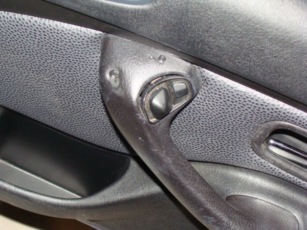

NZ00Z3
New Zealand Zeds
Dec 9, 2014
158
Timaru, New Zealand
3.0L, 2.8L, 2.0L Z3 Roadsters
Here's a photo of a DIY repair to the drivers door handle on my project car (it came this way). As I'm going to be looking for top $ when I sell the car, the handle is getting replaced. Yes its expensive, but it will look the good.
