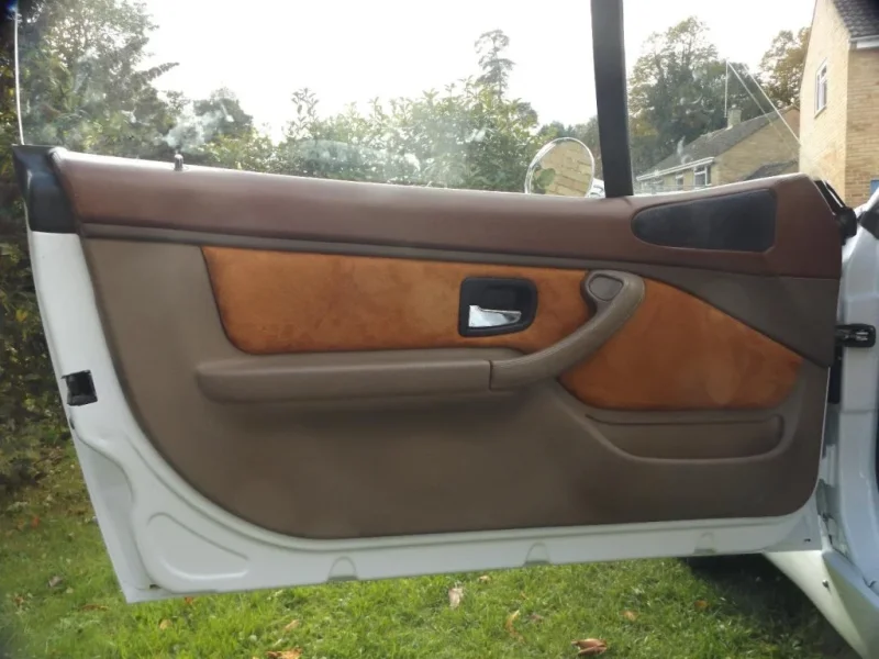

... On reassembly i drilled tiny holes into the remains of the rivets then i used ... small screws.
This is my Z300S Barchetta, the 4th one built of 8.
I painted the tops of the door cards and for the inserts, covered them with alcantara fabric.
Fastened them as above but with washers under the screw heads. Yes there are a lot of them.
