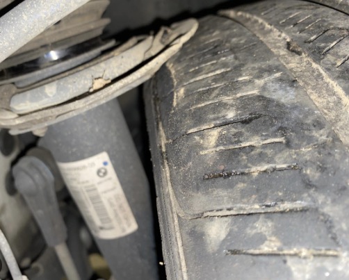

Do Coilovers increase clearance?
Duncodin
Sep 8, 2021
139
Pontrhydyrun
Z3 M44
This photo is not my car. I just swiped it off of the interweb.
My tyre is pretty close to the spring seat. Like in that picture or maybe not quite as close.
But I want to put taller tyres on.
Please lets not discuss rolling radius, incorrect speedo, Speed sensor errors or whatever else. I will worry about that later. Just want to know about the 'physical' clearance issues.
If I went for Coilovers then they wouldn't have that ginormous spring seat. Is that correct? Anyone have a similar photo of their setup with coilovers to give me an idea of how much clearance they have?
Thanks y'all.

In regards to the first picture, remember that the tyre and wheel is fixed in relation to the shocks and strut spring plate (cup) . Only the spring and inner tube will compress. Clearance of any kind should still be clearance enough.
However, if you are looking to increase the sidewall and to an extent, width of tyres, you will have less clearance. But if it clears, it clears.
Coilovers are effectively the same. Due to their design, without wide spring plate cups, you could have ability to run more sidewall.
Increased tyre Width can be accommodated with spacers, subject to offsets as well as sidewall itself if things start to foul the strut spring cup on fixed dampers.
So yes, Coilovers, due to the spring design could give you more clearance for chubbier, wider tyres.

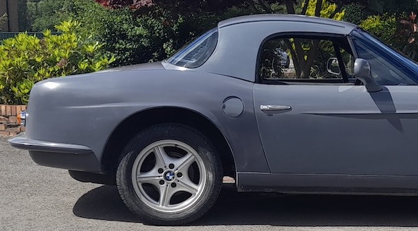

Why do I want to have bigger diameter?
I have these arches to fill. Sure I could lower the car but that only decreases the gap at the top. Arch gap in front of the wheel and behind it will still be giNormous.
15 inch wheels makes for a more classic look and 205/70-15 would reduce that arch gap by appx 2cm all round. Then just a little bit of lowering and I think it'll look OK.

Stevie. Did you see this picture?
205/70-15 tyres are not wider. They are taller. They would not fit with that spring seat where it is.
Are you saying that your 25mm spacers would bring the wheel out far enough to allow for a 30mm taller tyre?
