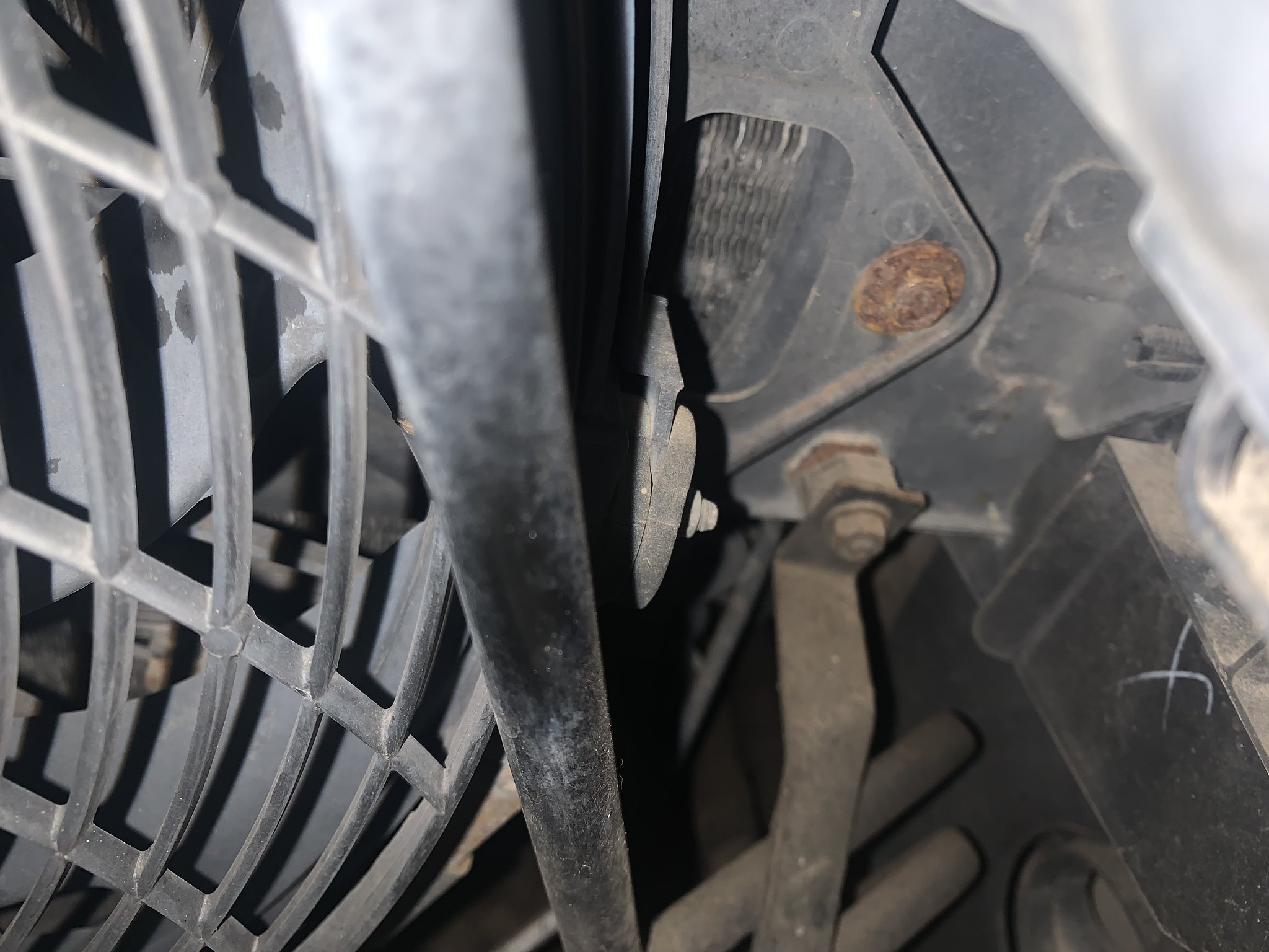

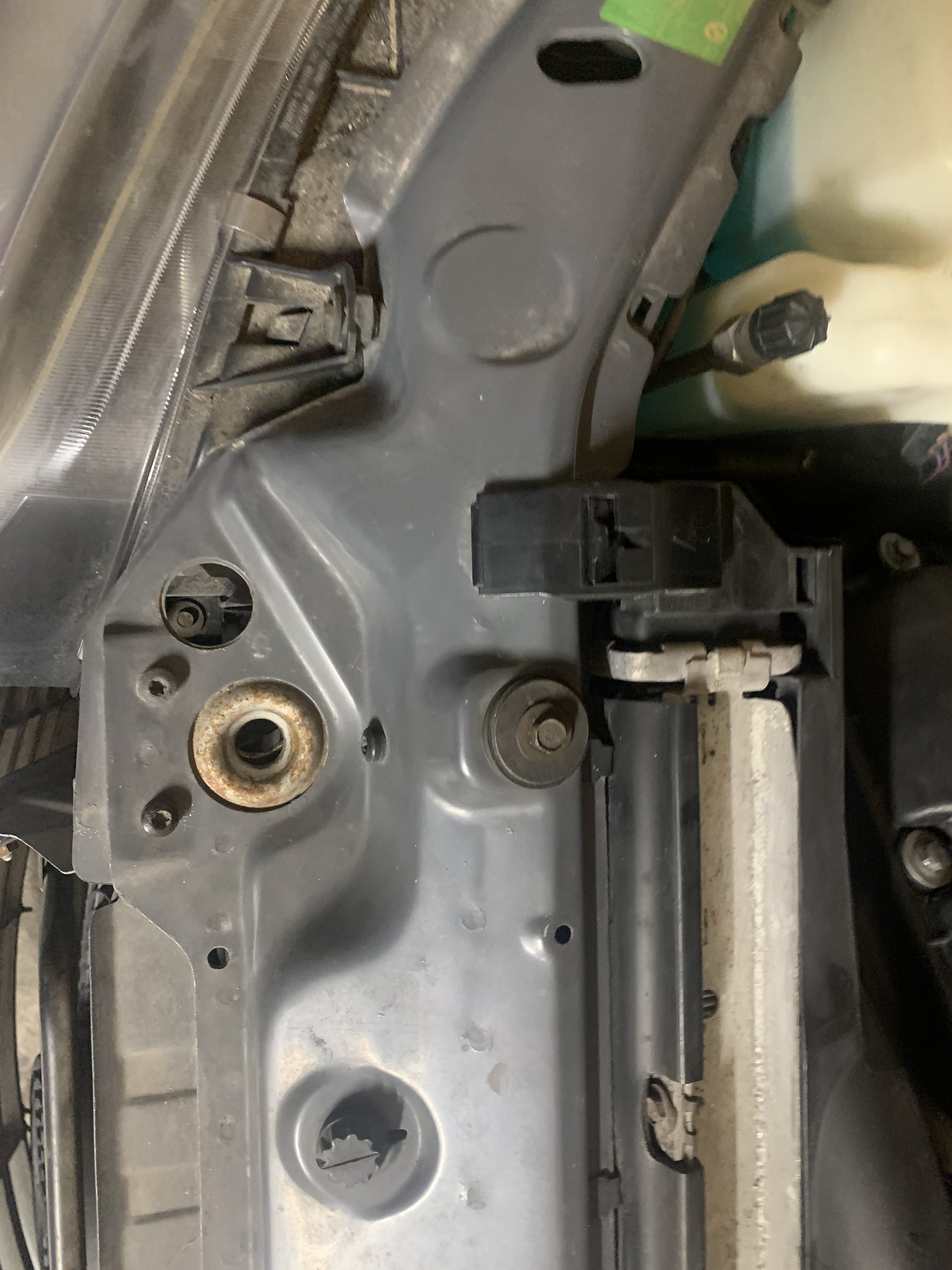

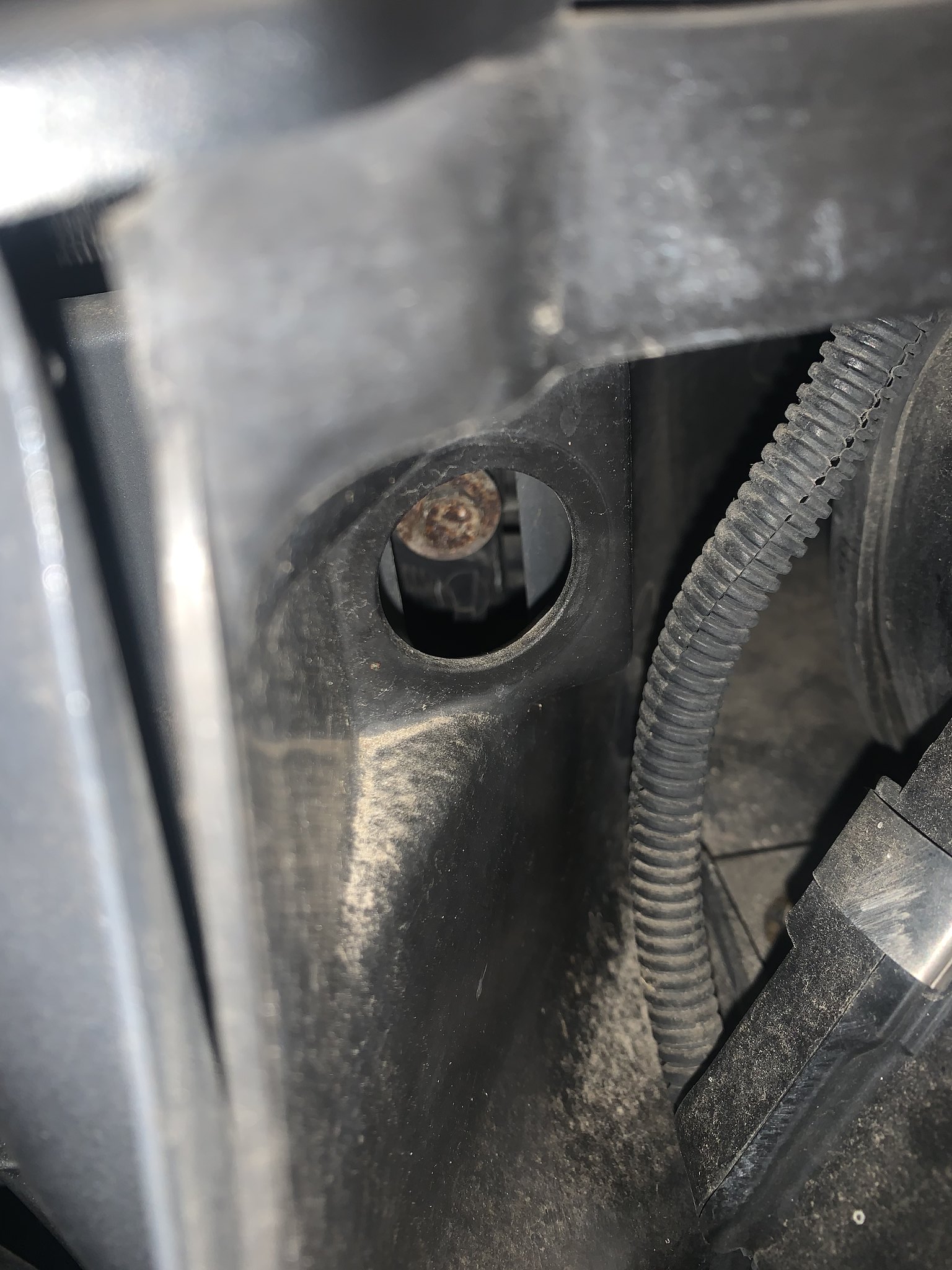

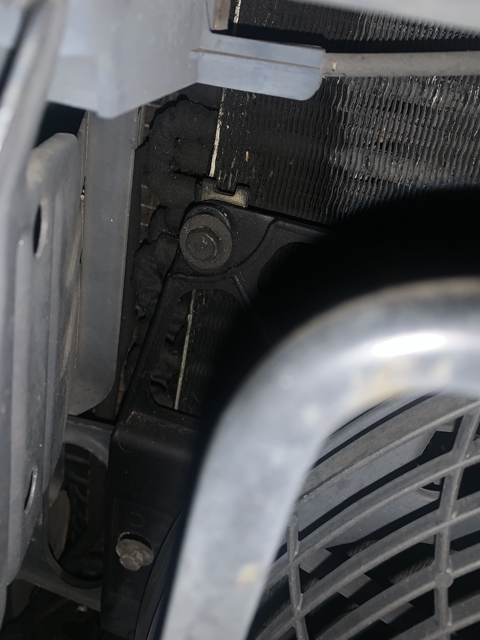

Removing the condenser. There are 6 10mm screws
Two on the top of the radiator support
4 on the front of the condenser...
Two on the right side
The lower left bolt
The upper left bolt - need to look into the opening

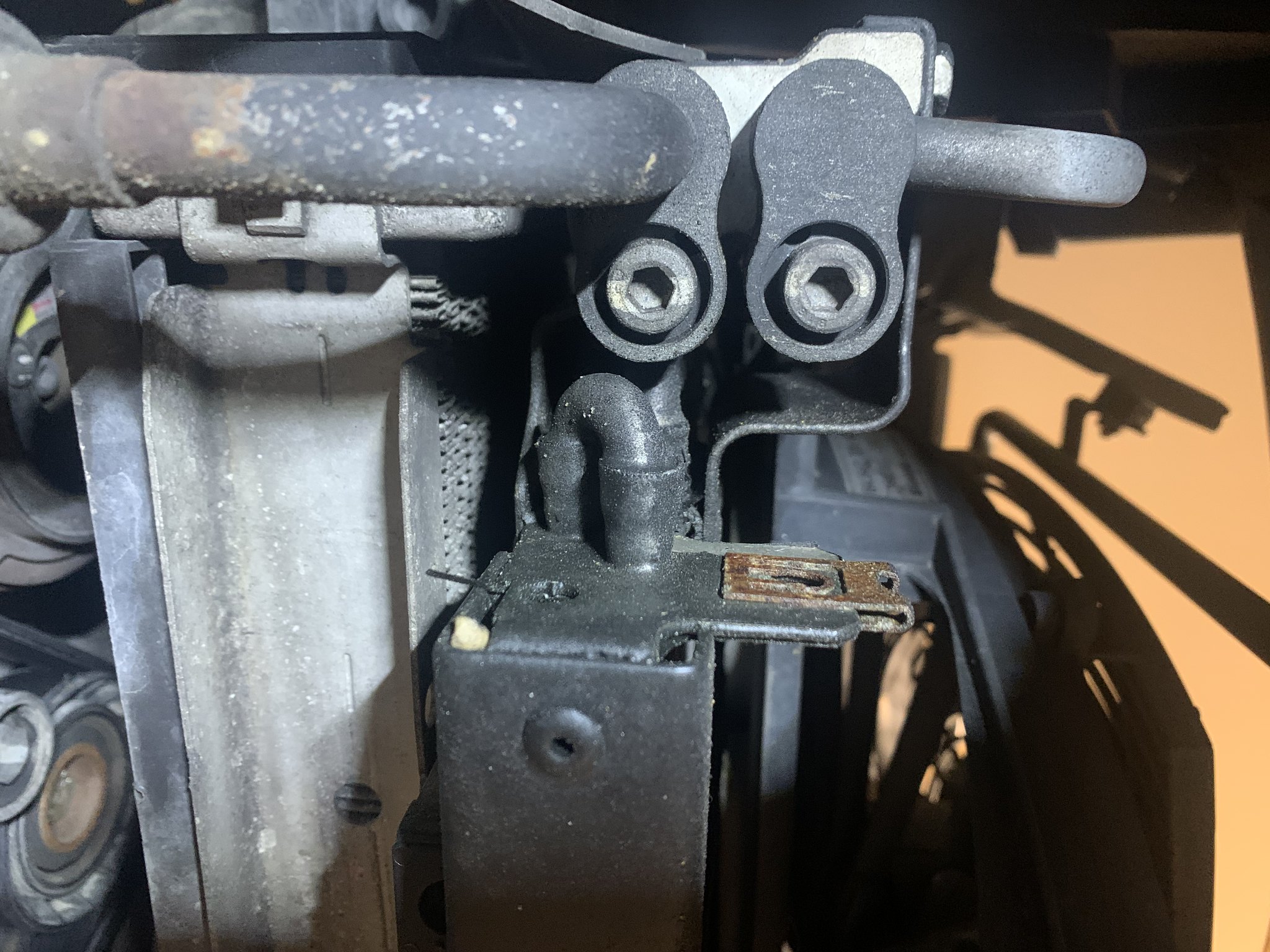

Two 6mm hex bolts which hold the lines.
Then just wiggle the condenser out from the bottom. Then install in reverse. A second set of hands will definitely help hold the condenser in place while you get the screws started. Install the lines and then recharge the AC.
