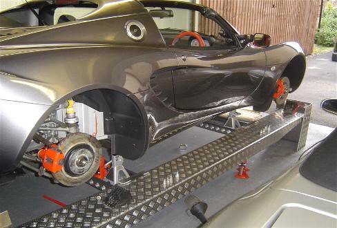

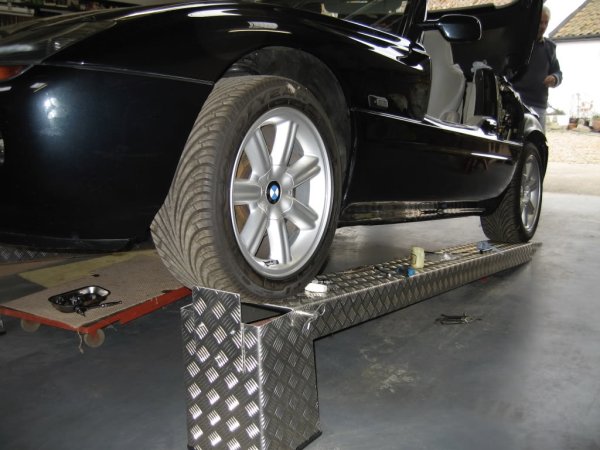

Hi Ade, welcome from me near Lincoln. Here's my take on raising a vehicle to do most things from servicing to cleaning the inside of the wheels.
I've made some modifications with mine so that I can move it out onto the drive to use the full lift range on a dry day.
Also, as our son is a joiner we sometimes use it as a woodwork bench too by fixing a couple of 3" x "2 bearers on to the legs and a sheet of ply etc. as a work surface.

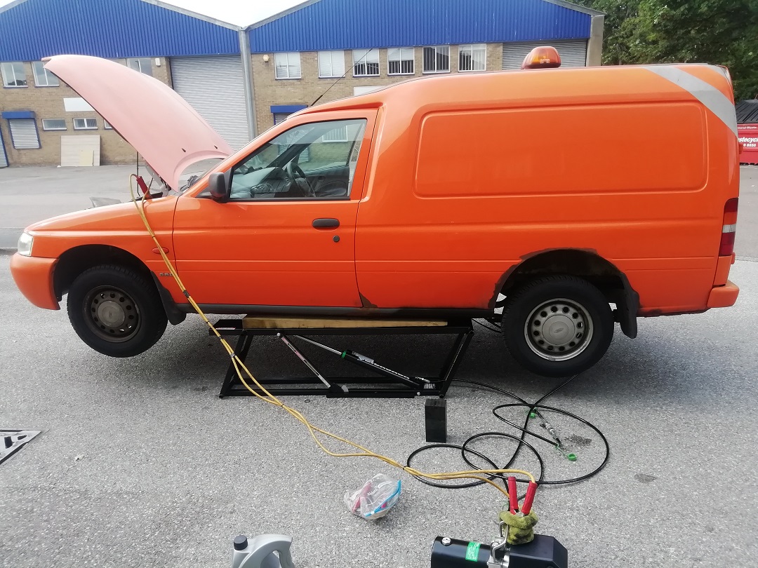

here’s what I use;
Approx £85 per side. Gets the car nice and high for working underneath with good accessibility. You see the issue with the fronts, rears are fine. I am working exclusively outside however.

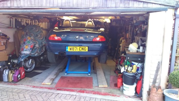

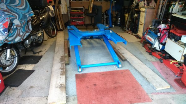

I have the same scissor lift as @t-tony, best thing I ever bought besides the Z3 and Z4 I have. Makes life easier and lifts the cars high enough to do most jobs I encounter on my cars and other members cars who are members of our Zedshed Cymru Group here in South Wales. Probably cope with a gearbox removal but car would have to be positioned reversed onto the lift to keep the rams at the rear of the lift to allow the box to be dropped out. Lift comes with extendable stands to increase the height if more clearance is required. Mine is in a small double garage and I have scaffold board planks either side to drive the car over the lift. It would fit in a single garage side space may be limited to get around the car but could be off centre to work on one side at a time then reverse the car for the other side. It can be moved by attaching some wheels that come with it and using the pump unit to hook on and manually pull it along wheels have to be removed when positioned in order to use the lift. Mine stays in the garage all the time. It also needs a dedicated 30Amp wired power socket think cooker socket, to run the pump, normal 13amp circuit will trip the house circuit breaker.

Drive on scissors lift for me. Good central access for servicing gearbox, prop etc but does hinder sill work a little.

In an ideal world I'd have a two post lift giving full clearance underneath. But that just wouldn't work in my single garage. So went with one like Tony's. Different brand. Different colour but looks identical.
Lots of space underneath depending on which way the car is driven into the garage. Here's a view of the rear end clearance.
And, as @colb said, drive the car in the other way and there should be enough space to drop gearbox to do clutch etc.
