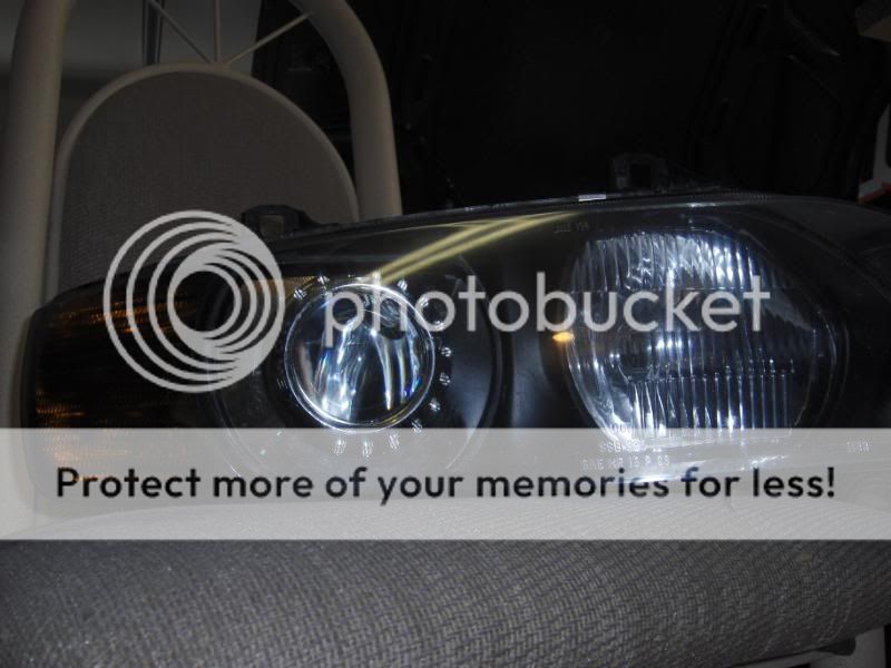

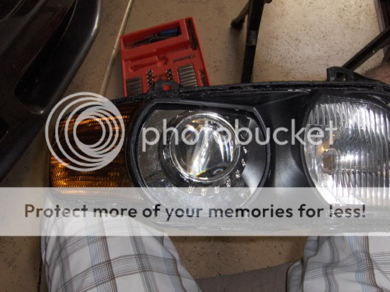

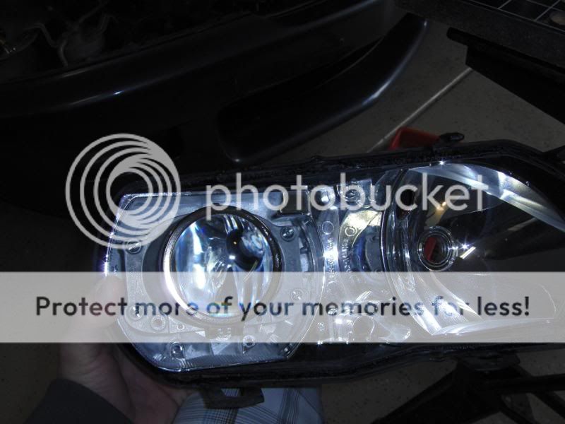

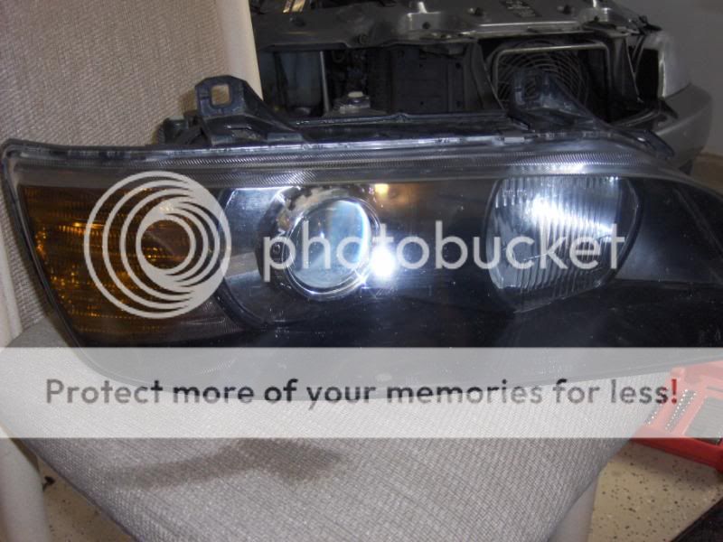

Here is what I had to start with:

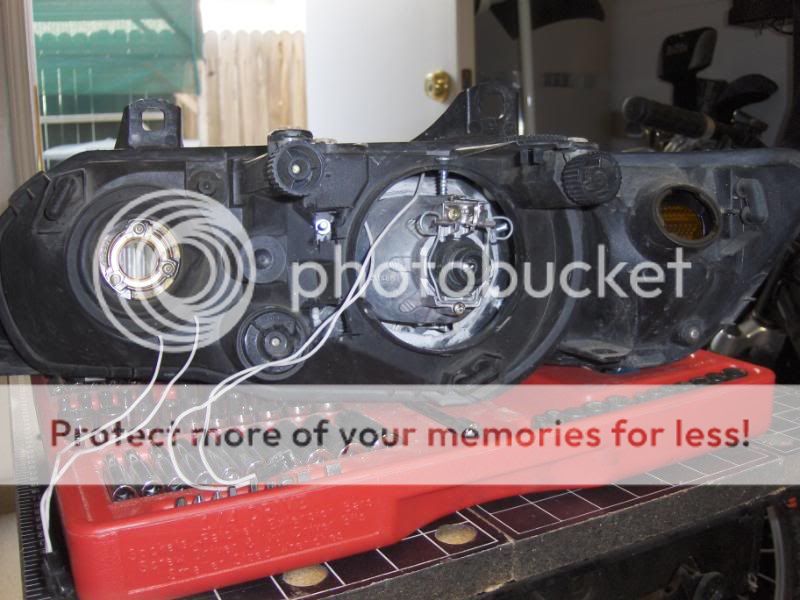

I had the projector already installed so this is what the back of the headlight looked like.

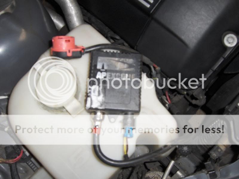

Here is the Apexcone 55W "Race" kit with the D2S connections

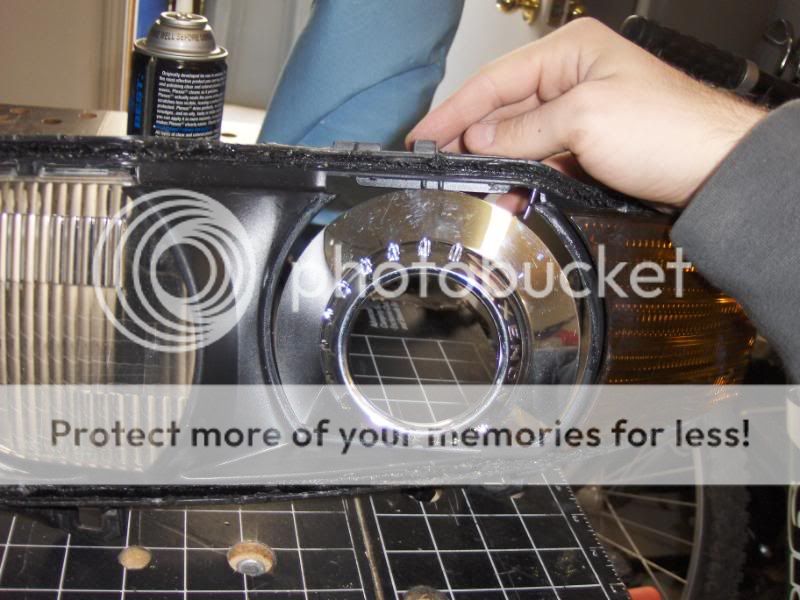

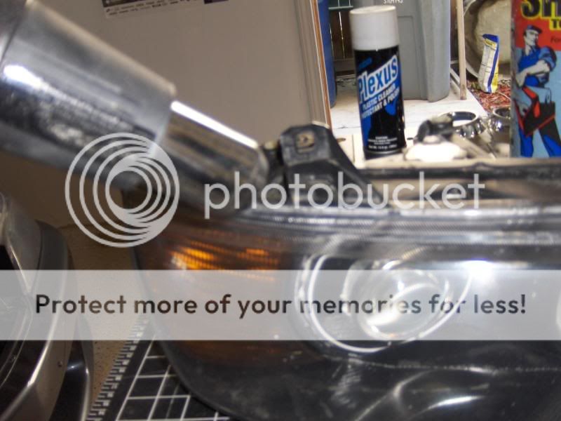

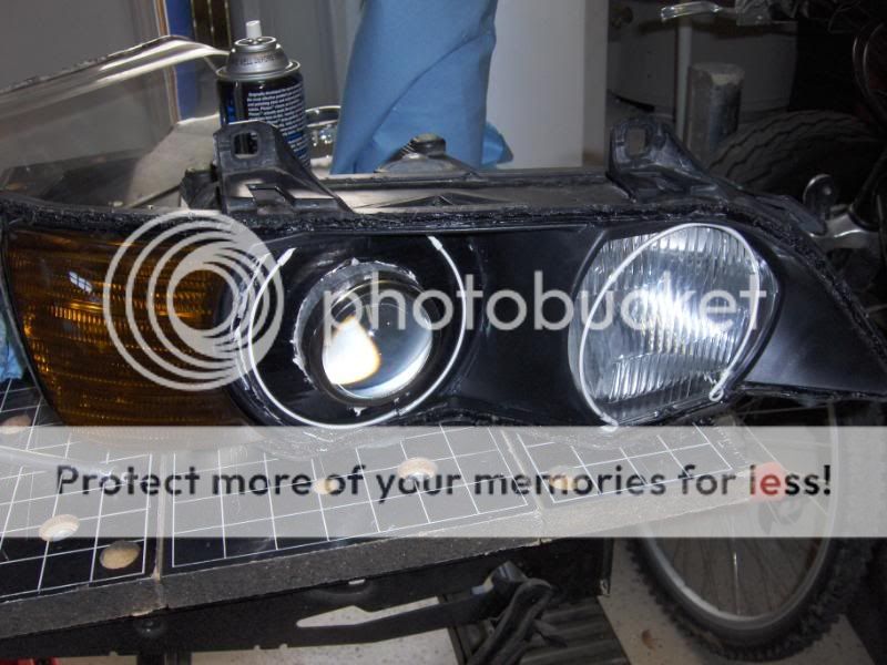

Next, instead of putting my headlights in the oven I break out the heat gun and slowly heat up the seam of where the headlight and lens come together.

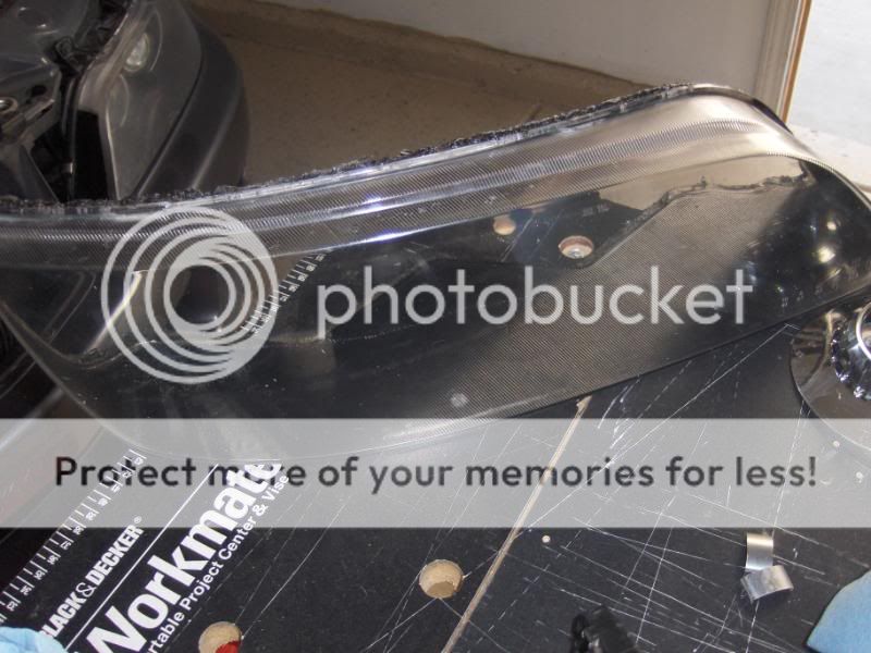

After you take off the clear plastic cover you have to take apart the back part with the heat gun. Here is what the projector looks like once I ripped off the angel eyes and the black that was around it seen in the previous picture.
Here is the shroud and how I wanted it to look in the headlight assembly (it's actually upside down)

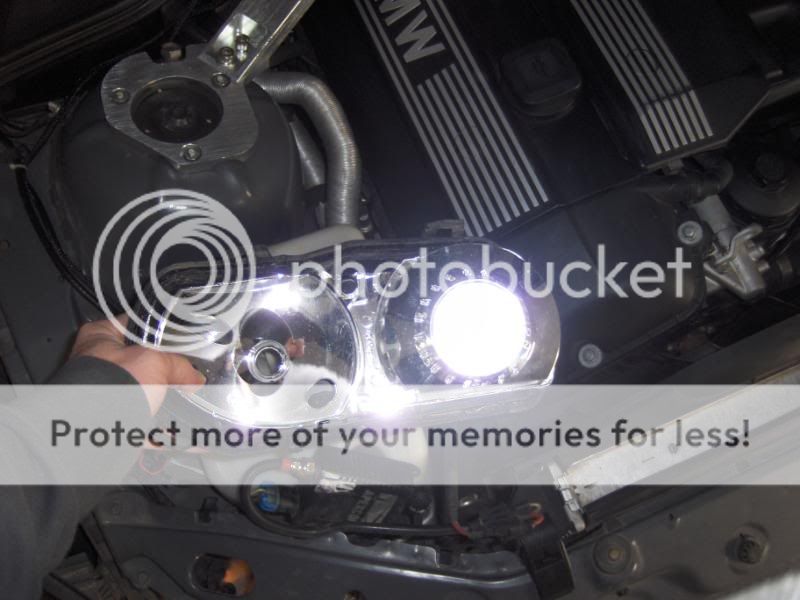

Got the shroud attached and checked the light output to make sure the shroud wasn't interfering.

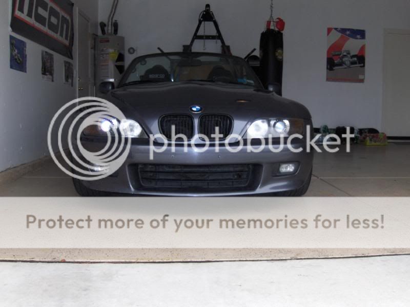

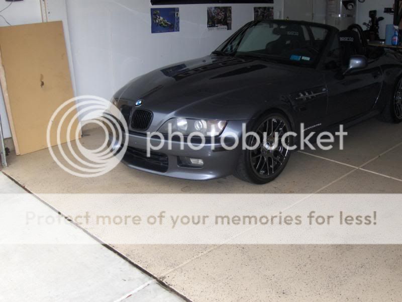

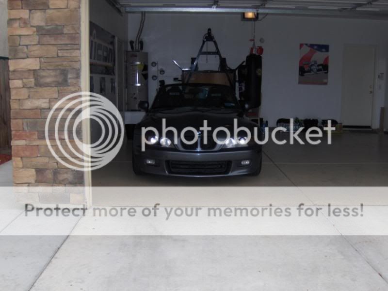

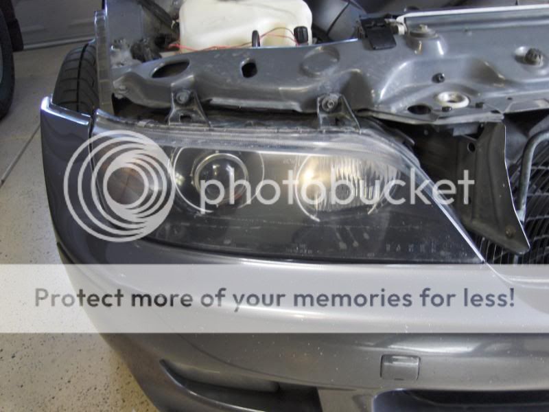

Just reinstall and your halfway done! Here's what it looks like after the conversion was complete:
