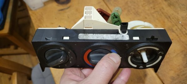

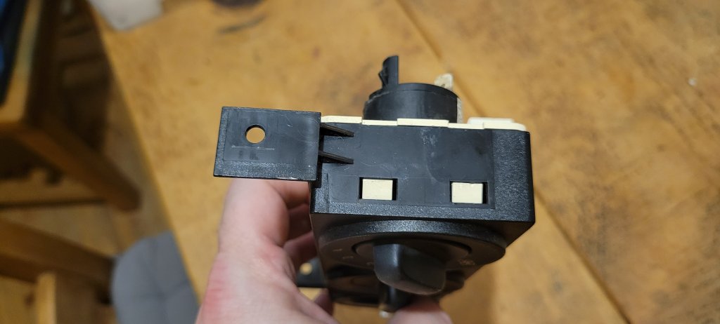

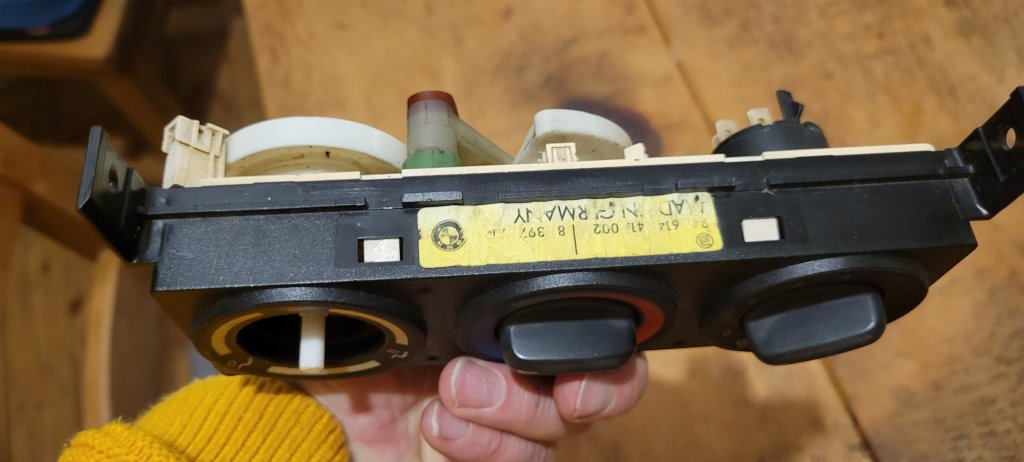

Has anyone come across a guide to take the heater controls apart? I need to modify mine to swap the temperature control for a pot in my EV conversion. I can find lots of guides to other bits of the heating but no guides as to how to actually take the controls apart.
May end up being brute force on this spare one to work it out. I can push the white tabs in but can't get the thing to separate. And while one knob has come off, the other two seem to be fixed solid. Just stiff?
jaguartvr
Jan 9, 2017
95
The knobs will pull off, use brute force.
Press the white tabs, you need 4 hands to press a few at the same time and you will be able to split it.
