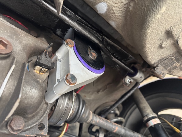

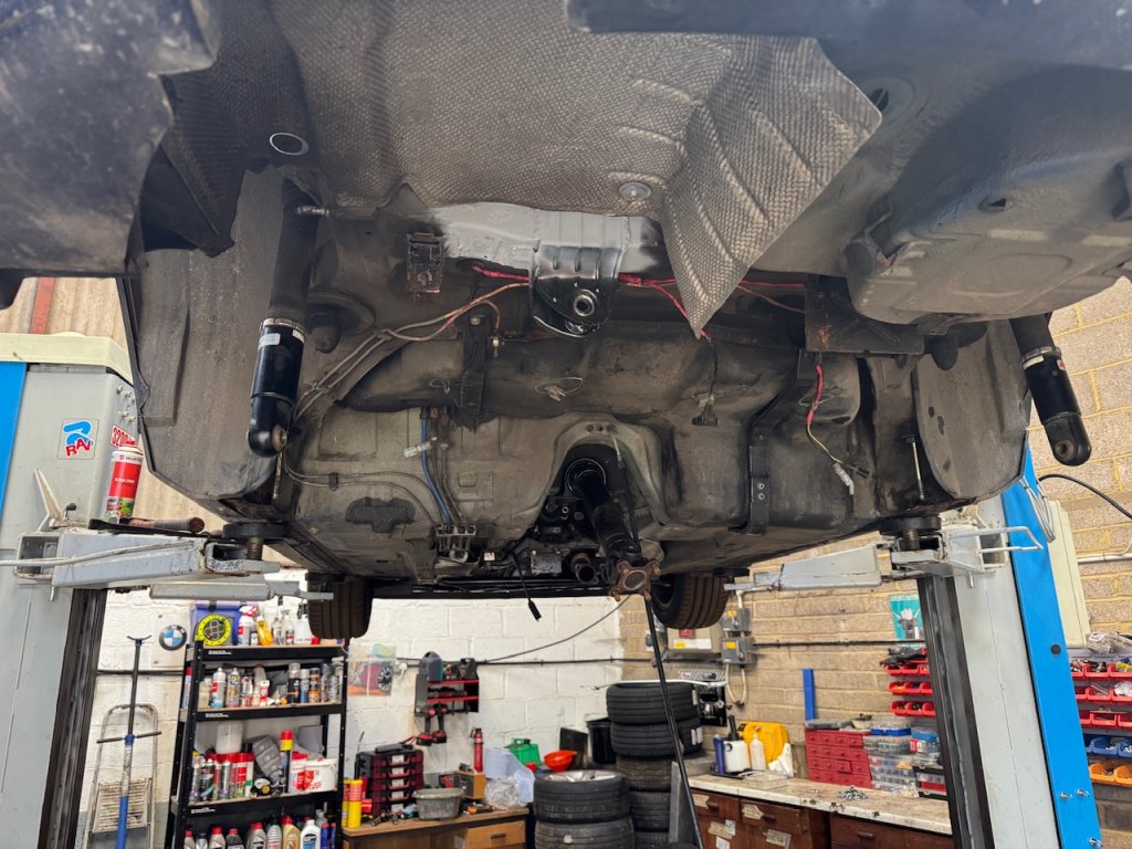

also down the back we’re heading up to fit a selection of upgrades. We have the bush offset kit to reduce the wheel camber. Also an extra support bracket to fit, this requires the spare wheel hanger to be removed.
