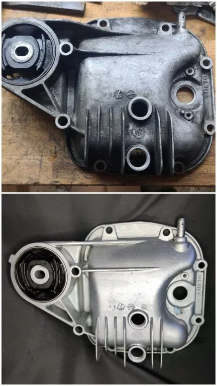

Hi,
I am looking to remove the rear diff cover to replace the rubber bush that is starting to break up and causing the odd noise. I can find torque information for most of the fastenings, but not one for the six M10 bolts that hold on the rear cover.
Anyone out there got any information on this?

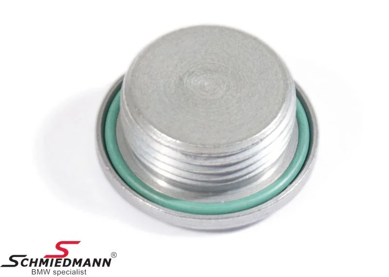

Arm yourself with a pair of filler and drain plug sealing washers when rebuilding it, they are alloy and corrode, been changing Diff oil on some Z3 and Z4's and everyone has had corroded alloy seals, I now use copper sealing washers when doing these and keep a stock in the Zedshed Cymru workshop so have them to hand when needed. Sourced from Ebay Copper Sealing Washers 22mmID x 27MMODx 1.5mm.

Have a set of replacement plugs and washers ready to fit. Have stuck with the original BMW alloy ones - I like to keep things stock if I can
hard top
Dutch Zeds
213
Netherlands
Had the plugs blacked (cannot remember what process was used) to stop them rusting.
Possibly dipped in a bath in an acidic solution of iron, zinc or manganese phosphate, I used to do that with threaded parts of our oil & gas equipment.
