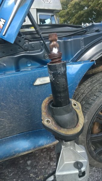

the Nefyn cat
Oct 19, 2014
174
2.2i Sport
My creaking/graunching turned out to be coming from the bush at the bottom of the column. Took the whole lot out and gave it a good spraying, must be a year ago now and hasn't come back. Yet.
Sure I remember something about a bloke with the same problem, not on a Z3 but one of the saloon equivalents, he drilled a small hole at the lower end of the column above the noisy bit and got grease in that way. Might be easier than taking the column out if you feel the urge to go that way.
