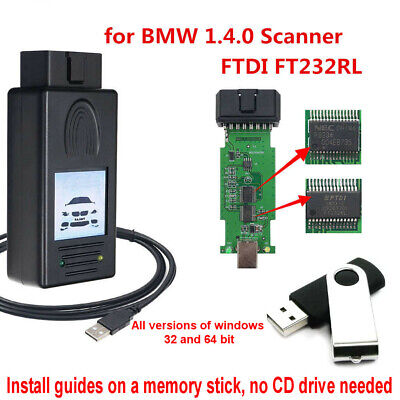

Sounds like it's in transport mode sure sign is rear screen heater not working and blower only on one speed. Can be reset with bmw scanner 1.4 on a laptop or a high end scanner. Transport mode is invoked when car has low battery it closes down systems to preserve power for starting. Where are you someone close by may be able to reset it for you. I can in South Wales but away on a cruise till the 15 th April.

Inpa probably do it as well but Scanner 1.4 easier, my Launch tablet scanner can actually delete it from all the modules it resides in so it never happens again. Scanner 1.4 only resets it to normal.
Foxwell readers can reset transport mode too.

Quick update, 1.4 scanner arrived yesterday and we are now out of transport mode, thanks for the recommendations chaps, hope to resolder the outside temperature sensor wires tomorrow and clear the last of my codes, have a new sensor just in case it’s not the wires!

Be aware computer updates will mess the scanner 1.4 driver up keep a copy of the driver filed away just on case you need to reinstall the driver in the future. It's a good tool for beginners as it's so easy to use.
