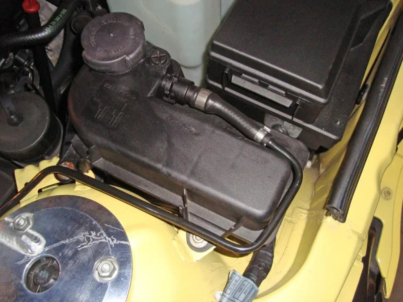

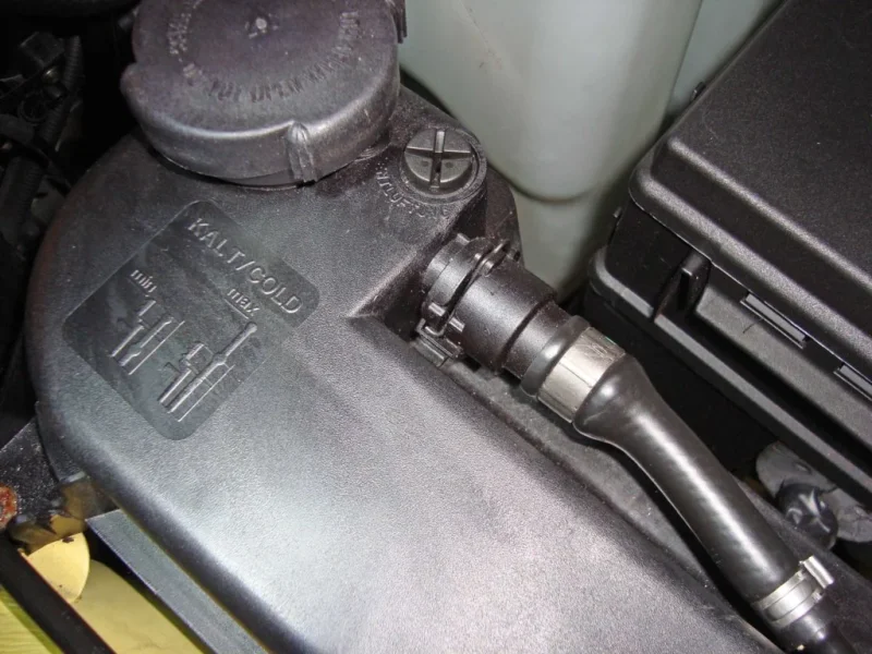

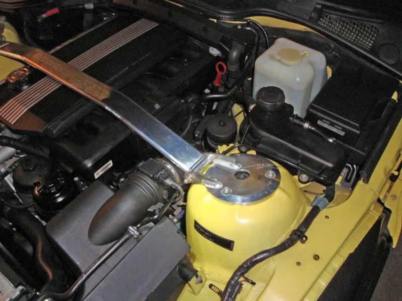

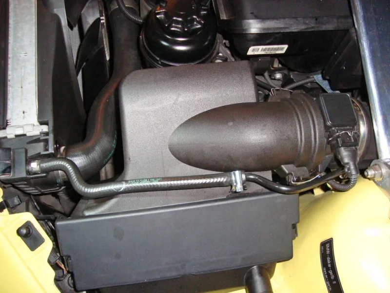

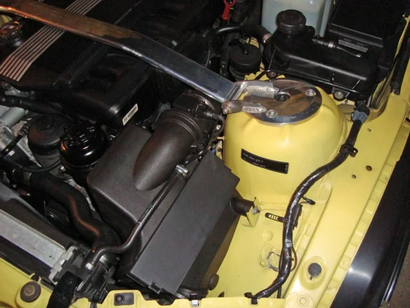

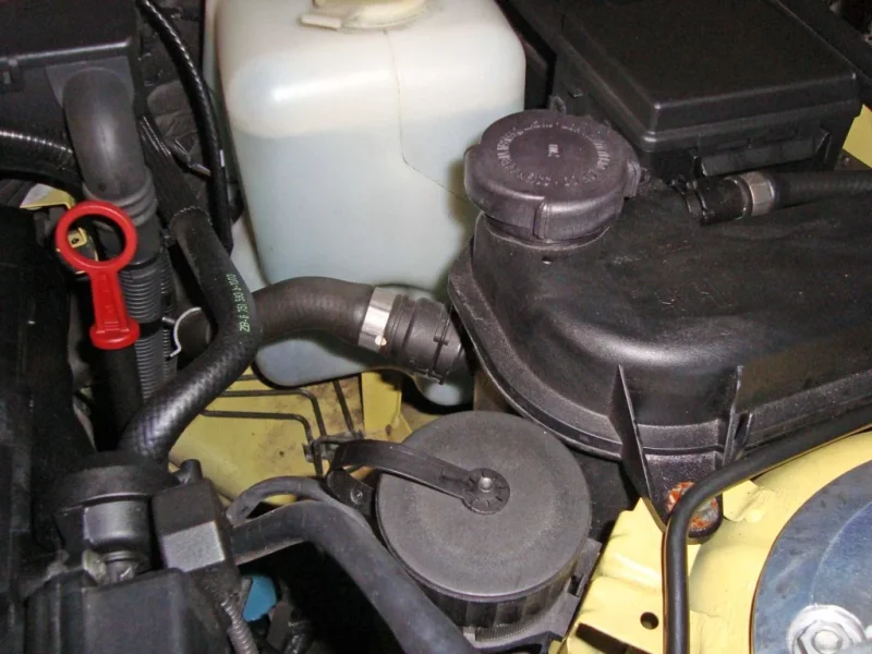

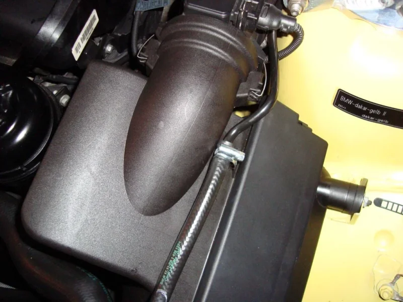

Does anyone know the BMW OEM Pt No for the hose that runs between the top of the radiator and the top of the 'top up/over flow' water bottle.........please see pics.
I'm afraid that there had been a 'weeping' leak in the joint that lays on top of the air filter and solid plastic pipe. I unfortunately over tightened the hose clip and snapped the solid plastic pipe in half :bashhead::bashhead:
I've just been to two BMW garages; and both are struggling to locate the details on the damaged hose.....they can only trace the details on the hose that runs to the base of the over flow water bottle.:(
I have now been requested to send the attached pics to BMW.............but I was hoping someone may be able to beat them to an answer. :)
Cheers Brian......this is the one that both BMW garages found............but it appears to be the wrong shape and is shown entering the base of the expansion bottle :(
Hopefully its a 'generic' drawing.........one of the BMW garages is ordering the part in, but was not confident :(
I'll see what arrives tomorrow..........fingers crossed.

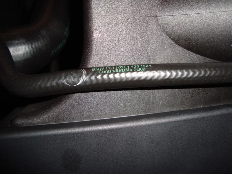

Isn't that the part number marked on the pipe in the first picture?
Please see my comment in posting no. 4 :). Both BMW garages were unsure about this Pt No. as their computer diagram looked completely different.
I have just collected the hose and can confirm that Pt No B11.53.1.436.122 is the correct item :):):)
Sorry to jump on this thread but as fate would have it, the plastic pipe more or less disintegrated as I was moving it to put the air box back in. That wouldn't have been so bad but when I tried to repair by putting a washing machine inlet hose over the broken end that just crumbled too......and so it went on until eventually I was left with about 5 inches from the expansion tank and a nub going to the radiator!!
I plan to make a temporary repair until I can get some more.....and that is to take what's left of my washing machine hose and connect it directly from the expansion tank to the radiator by use of jubilee clips.
On Monday I'll get the replacement.....
Any problems with this??
@dva99999 You should use 8mm copper tube bent to shape and use two jubilee clips to connect into the rubber hoses either end. I did this for @Shortie_gal 's Vixen when the plastic went brittle. Worked very well and was replaced when the new part arrived from an eBay seller. very easy to do as well.
Photo showing how easy it is to fabricate. Just use you fingers and warm the pipe as you bend it.
