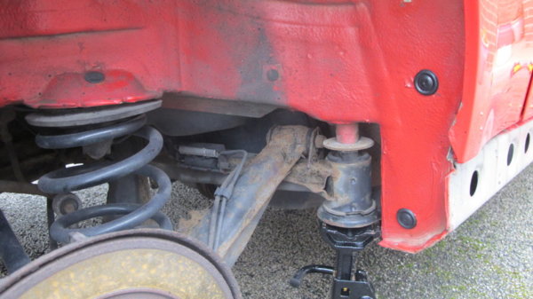

I have been reading all the various threads on the forum relating to rear end removal of beam and axle to replace all bushes, springs etc, but I am now a bit confused.
I have a picture of my cars beam bush,( when doing the sills) and one taken from the forum.
The beam bush on mine shows a space above the bush ( and is the same on both sides), and on the other picture shows a space below. Which is correct and why would there be a space?

This pic shows mine - which as far as I know is original assembly - seems to agree with yours

Where the bush sits at the bottom like these it shows the bushes have had it. The beam should be supported above the bottom plate hence there should be a gap. Going over a harsh bump at speed you will get a knock from this.
So is this an automatic MOT fail ?
Sorry I am being really thick....
Assuming new bushes installed in the beam, the beam pushed back in place up to the upper stop on the studs
, what actually stops it from dropping, as the M14 nut is under the bottom plate

What stops the beam from dropping is the massive bolt anf nut holding it along with the bottom plate.
Not to mention it's attached to the diff casing and shocks

Totally agree with the above. The bushes are shot so they are sagging or torn. Depending on brand depends on how they sit.
The beam should sit pretty central once replaced.

Back to the original question about the beam bushings.
The difference is that your bushings are old and saggy, whereas with new bushings the beam is held up and off the bottom plate. I noticed this difference when I change the bushings on Mora.
