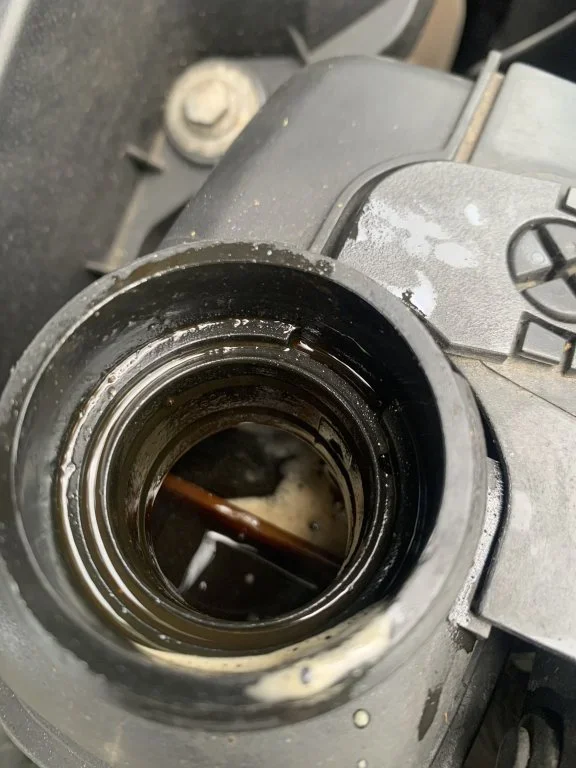

Hi could get some advice for n this please.
I‘be done a compression check on n my 1997 year 2.8 Z3. The results are as follows from cylinder 6 to 1:
200, 120, 115, 140, 200, 135. Plus see attached photo.
The garage I initially took it to said they thought it was an exhaust valve then concluded it was nikasil.
since getting the car back I’ve done the above test and noticed a little ‘mayonnaise’ in the expansion tank, plus the oil level is below minimum (recently did an oil change - correct amounts).
There is blue smoke sometimes on start up.
I’m a little unsure where to go with this could it just be the head gasket? And or more? Do I just sack of the engine and take a chance on a second hand unit?
Thanks
Look for a good used motor, preferably c/w MOT emissions receipt.
Andyboy
Jun 2, 2019
119
SHEFFIELD
That's not clever.
The problem is finding a good single vanos 2.8...they are like gold dust now. Later twin vanos units are more common but would be a lot of work to fit and make work.
A head gasket replacement is a can of worms. It's doable but you will almost certainly need to drill out and Timesert on the block where the head bolts screw in. If not you can pretty much guarantee one or more block threads will strip on torquing the head bolts. I've done that tango too many times.
Short term fix - drain the coolant, flush it out with clean water and tip a bottle of Steel Seal into it. Unlike K Seal, it actually works.
