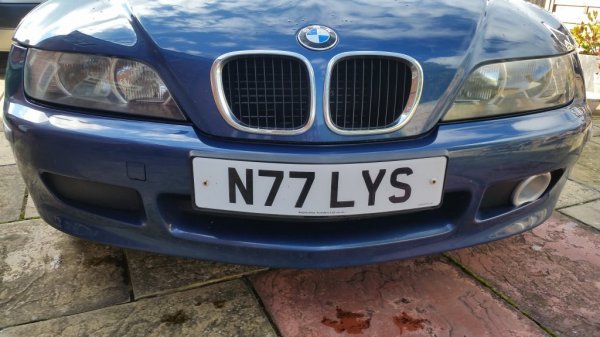

Just very quickly on this. I've been reading alot on upgrading the intake. However, most things I've read have said the intake is down towards the fog light. On mine, it sits between the headlight and the front grille. It has a "squeezed" opening. Is that normal? I don't want to alter anything if I don't have to!
