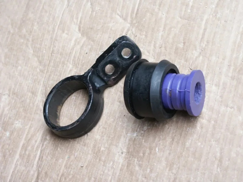

No.1: https://www.powerflex.co.uk/products/Z3+(1994+-+2002)-603/1.html
No.2: https://www.ebay.co.uk/itm/184556798618
if you could let me know which is preferred I’d really appreciate it! Thanks for your input my friend, all this is invaluable info! All the best Nefyn!

As pointed out the bushes best place to start. It can seem a daunting task to carry out but have a look at the Zedshed threads. There’s plenty of info there on front and rear end refreshes. Plus once you get carried away with tarting everything up underneath with a fresh set of new shocks it will look the dogs danglies.
Thanks for that Althulas, I had one set in my watch list on eBay for ages. But then I’ve just heard about Powerflex Bushes, now not sure which is the best choice. I’ve put the 2 links on Nefyn’s post (hope I’m allowed to do that? Sorry if not!). And I like what you say as I’ve always been interested in doing up underneath also. There’s a rear axle like I said to Nefyn, I was thinking could I Powder Coat it or Chrome it to something a bit more lively, but worried it may affect its purpose for adjusting Toe & Camber. I’m still not sure what them 2 are but I’m thinking it’s the stance of the physical wheel. I’m sure everyone else is the same but wish I could kit it out all at once but very much limited funds wise. But I’m hoping once I get all these fitted I’ll have a completely different experience in driving my Z! Thanks again Althulas, your & everyone’s input has eased the stress of trying to figure it all out on my Tod! I’m new to driving my own car so learning as I go along. But all the best my friend, thanks for helping!

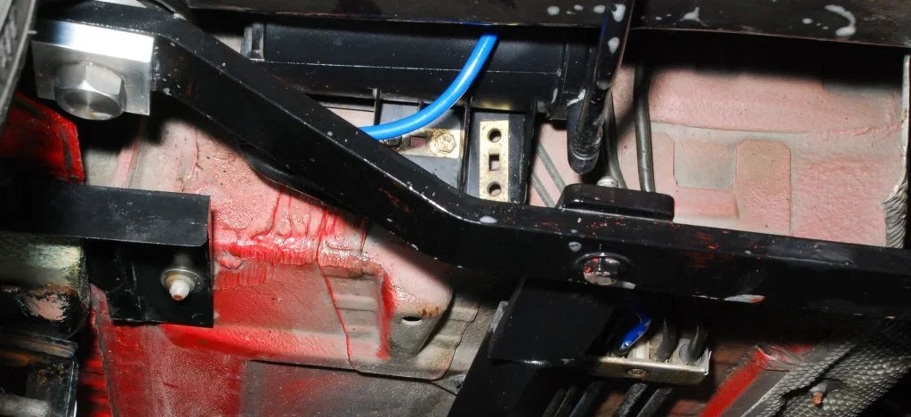

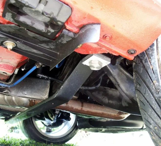

My car has many modifications aimed at improving handling, but - given that it has always been in good condition - I feel the best things were Strong-Strut's Butt Strut and Body Brace, and also Powerflex poly bushes all round - particularly those replacing the large bushes on the front wishbones. Have a look at my bit on Basic Z3 Suspension Mods in 'Articles.'

Bushes ---- Personally I wouldn't go Powerflex on the Z3 rear beam or diff again but stay OEM, but all the rest definitely Powerflex (Polybush)
Also I have just fitted the Eibach B12 Sport kit suspension (Bilstein B12 shocks Eibach lowering springs) to an E89 and find it just perfect, the kit is available for the Z3 too. @Ianmc has just got the same set up on his 1.9 Z3 and would agree I think.
