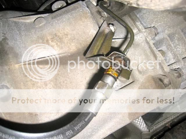

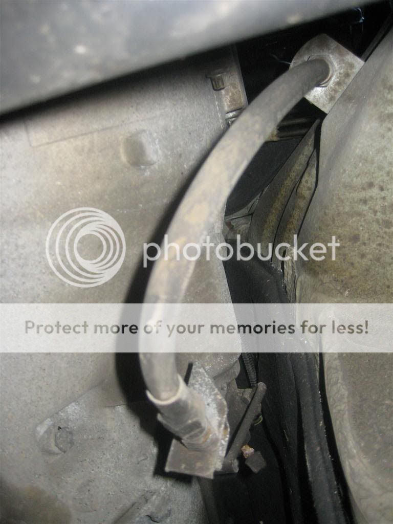

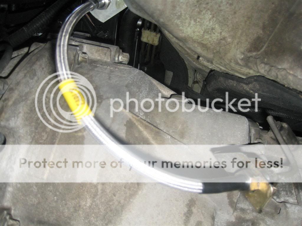

    Ray
    The CDV on ///Ms is incorporated in the hydraulic pipe
    It has a smaller hole at the slave end to restrict the release flow of hydraulic fluid
    The CDV delete comprises a straight through pipe in this case
    The illustrations in HT's link show the various CDVs fitted to non-///M BMWs
    This was mine (non-///M) before and after
    The CDV is clearly visible in the second pic after a squirt of WD40
    [​IMG]
    [​IMG]
    [​IMG]
