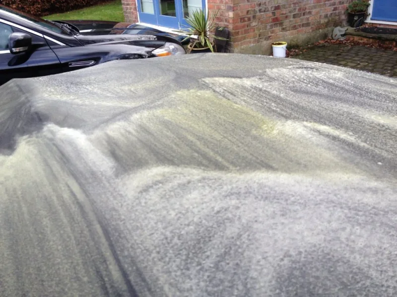

I've resealed the plugs in th edges of the front windscreen seal, and it's kept the car dry ever since. Gorilla Glue and sanded it back flat afterwards..
I was quite pleased to see the other morning when it was -whatever c that the water droplets were frozen like little spheres on the roof itself..
Shows the proofing is keeping the roof dry.. well drier
