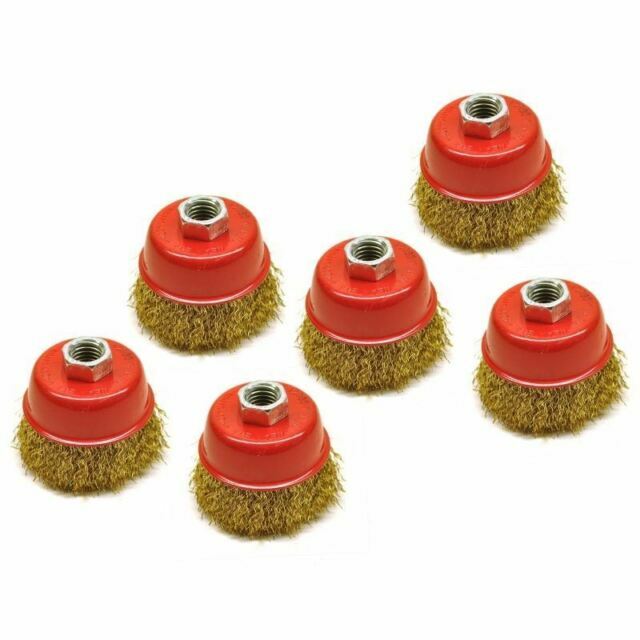

I am going to purchase an angle grinder and some disks to clean the inner sills, does anyone have any recommendations? Also what have you all been using to treat?

Sanding/grinding discs used on an angle grinder will remove metal quite quickly. Personally I would start by using a wire -cup brush on a grinder first. Such as these.

I used Bilt Hamber Hydrate 80 to seal off the steel once I'd removed the rust. Then painted with Rust Buster Epoxy Mastic Paint.

As Tony said I only needed to use wire cup attachments with a cheap corded angle grinder from B&Q for working on parts in the garden and has held up well for a sub £40 unit and borrowed my mates cordless Makita unit that uses the same batteries as my impact driver for working on the car in a lay-by.
