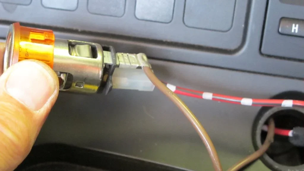

Mine just pushed out from underneath after I removed gear change panel for other work. If you do get it out pic shows wiring that should be there.F8557C07-E72B-45D8-8D8B-AFCF6E3D213B.jpeg
I found the wiring, but they weren't connected to anything, as the car was bought with the cigarette lighter delete option. What's in there is just a dummy to fill the gap, but it doesn't come off as easily as in your case.
