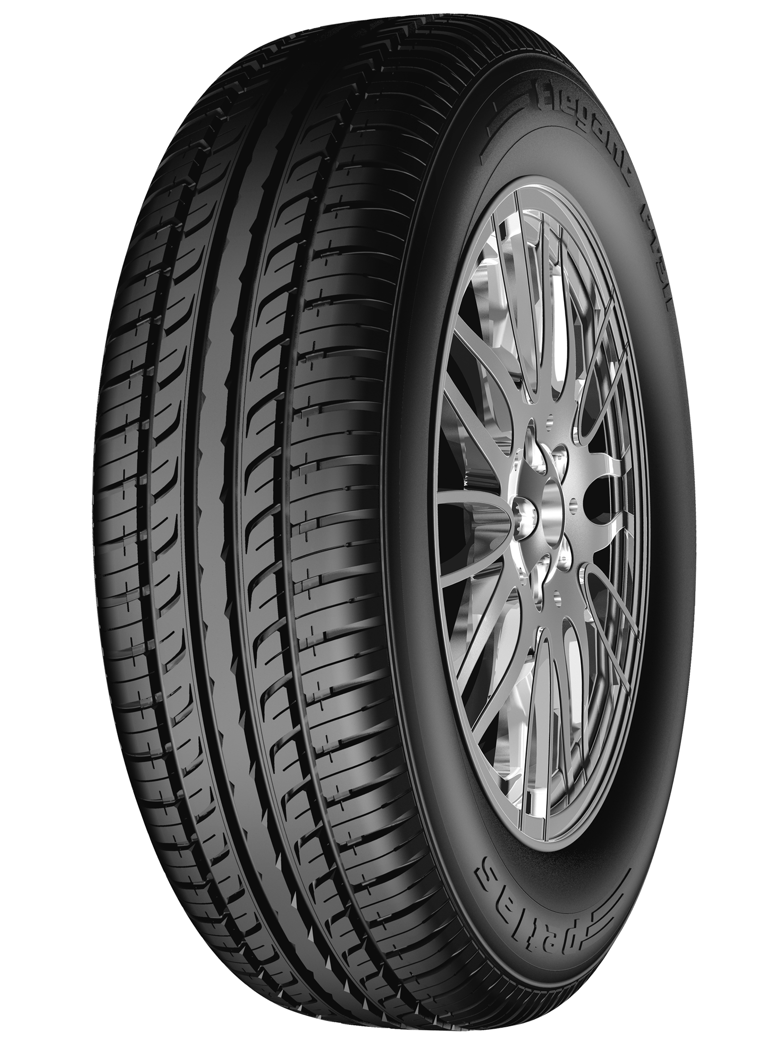

Ok. My new to me BMW E21 is not much of a sports car and until I decide what I am going to do with it, I just take it out for some careful driving.
In a month I have to get it in for inspection (local MOT) and definitely need new tyres.
my options are
Dunlop 185/70/13 at a mind blowing 255€ EACH
Barum Brillantis at 86€ each
Petlas Elegant PT311 at 51€ each
the Dunlops are unexplainably expensive and the reasonable choice seems to be the Barums.
but on the other hand… how bad can the cheaper Petlas can be?
any input on “cheap” rubber? Anyone has to share a success/horror story?
it is just 120€ difference, but why not spend for beer?

No personal experience, however ....
I think in conclusion you'd be better off using Weetabix as tyres.

Not sure about the Brillantis bit, but Barum are a well established and reasonably respected tyre, I would run on them. They are probably part of a major manufacturing group anyway. Guess the sun there can kill a tyre before they wear out and not a lot of rain (?) so slicks probably give better grip!!!
Undortunately tyres over here last about two summers. After two full seasons no matter the thread they are literally toast.
parking in a garage helps but still 40+ celsius (under the shade) and a real and recorded 57 to 60 degrees on the asphalt roads really kill them quickly.

I generally check how many sidewall plies cheaper tyres have. The really cheap ones are only two and generally fabric, much easier to burst. Personally I like at least one steel ply. Much harder to burst, not so prone to cracking.
Totally agree with Iain regarding sidewall cracking and also in between the treads too with cheaper range tyres. What we used to refer to as Siamese Slippers. ;)
