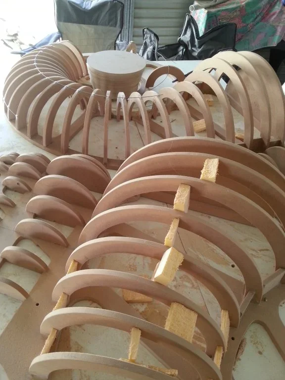

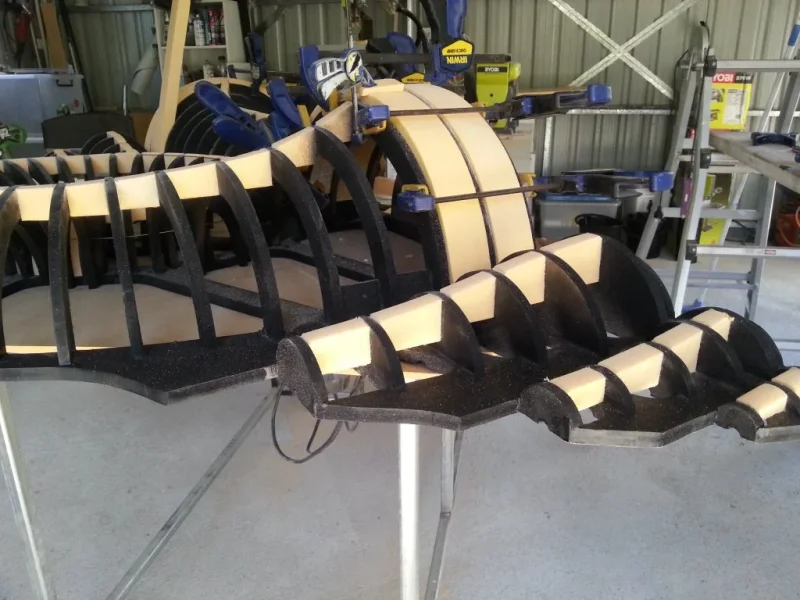

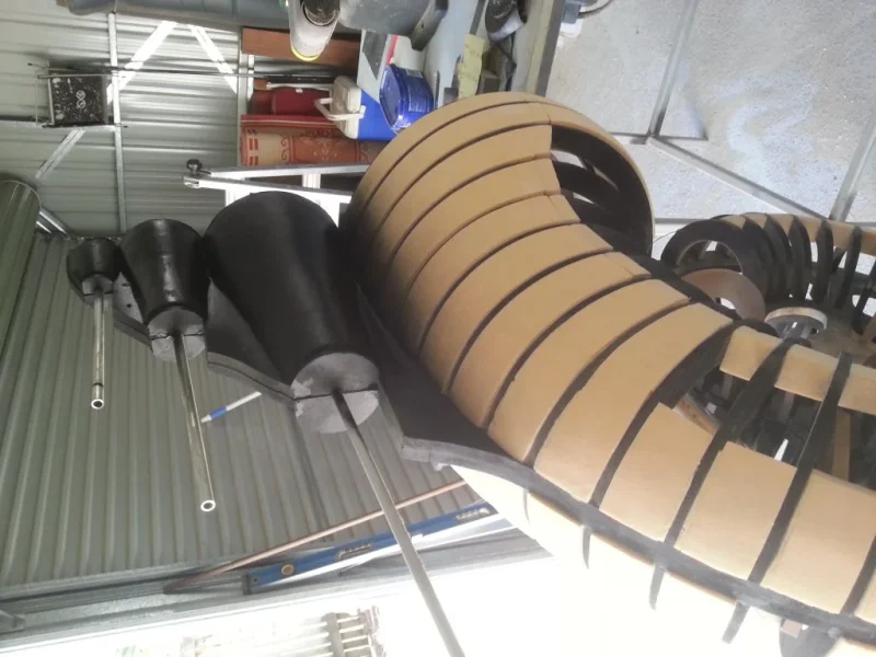

That is an interest method you suggest there, hmmm. Food for thought, I was going to build preliminary male plug from balsa, having built a few model boats and aircraft in my time. I will rethink that...:thumbsup:. I have attached a few pictures of the method I used for a very complicated shape, maybe they will help your thought processes.
These became the half plugs for a big silicone mold, notice the use of stainless mig wire for getting the curves right...The foam is closed cell modellers foam, polyurethane I think, sands well and fairly forgiving, good for aircraft wings etc..Either way, I will watch this thread with interest if it goes that way, because a cover with subtle humps is my next DIY, as long as it fits in the trunk when halved. :whistle:
