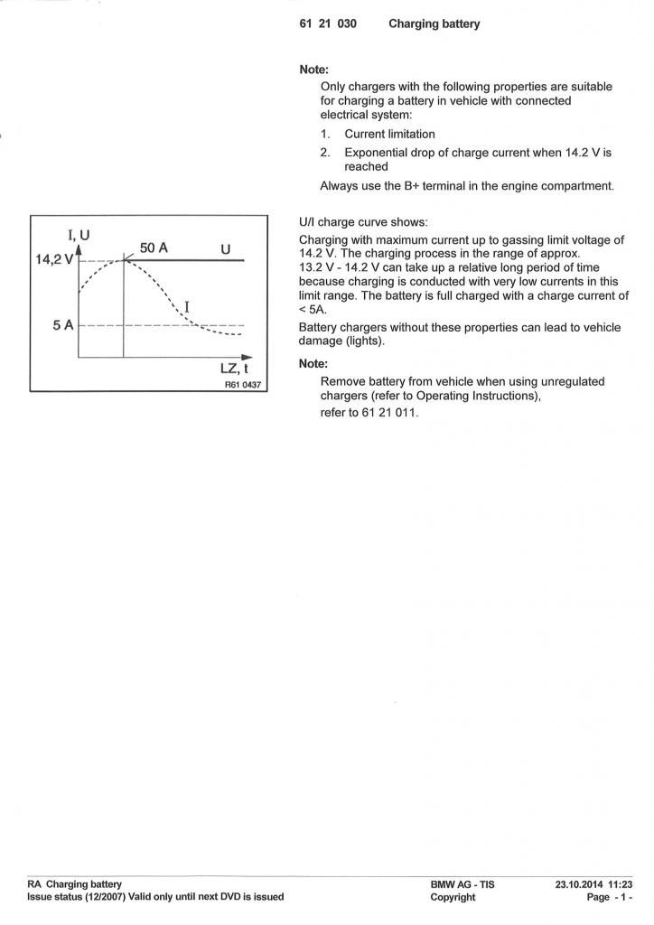

    I use my Zed only on weekends and I recently purchased a C Tek MXS 5.0 automatic charger to keep the battery on trickle charge. The voltage applied by the C Tek charger varies from 14.7-15.8V during the charging cycle, which consists of 8 steps. The BMW TIS has a section titled "Charging Battery" which states that the charge current should drop exponentially when a voltage of 14.2 is reached. As the C Tek charger generates a voltage up to 15.8, I am concerned if the charger would damage the car's electronics.

    Many thanks for the responses. Yes, we have Aldi stores here in Sydney and I have seen their battery chargers for sale at $29. I have no doubt the C Tek charger would apply a much lower voltage to maintain the battery but my concern is if any damage would occur to the electronics if the voltage exceeds 14.2 even in a short burst. I note that 14.2 is the voltage delivered by the alternator and posted below is the relevant page from the BMW TIS which has an issue date of 12/2007. Is there a later issue of this information from BMW?
    [​IMG]
    The battery I have is a Varta Silver E38 which is an AGM battery and I hope to use the AGM mode on the C Tek charger which will ensure that the applied voltage would not exceed 14.7V. I hope to use the jump terminals under the bonnet to connect the charger rather than to use the battery terminals in the boot. I understand that the terminals under the bonnet are connected through the car electronics which monitors the voltage. Any comments would be appreciated.
