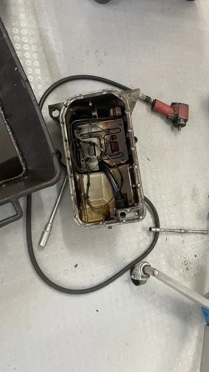

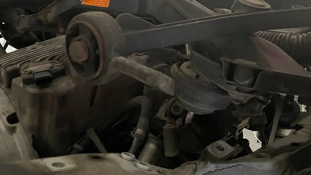

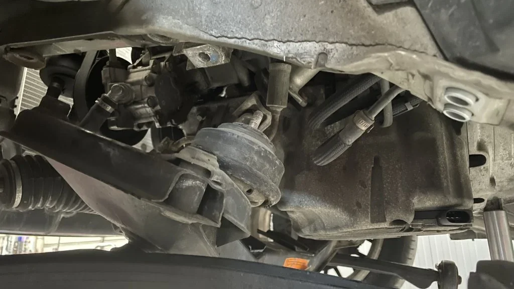

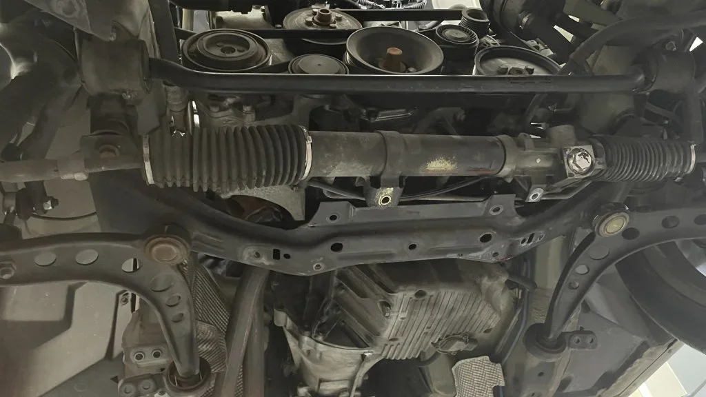

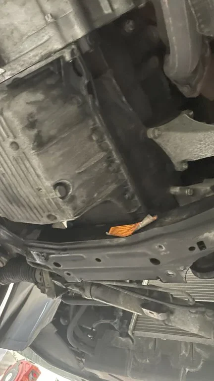

No idea about M44 but on the M43 I lifted the car, put a transmission lift jack under the engine to keep it in place, removed the cross brace, then used another lift to hold the front sysfem up and untightened the bolts until I could tilt the oil pan just slightly to slide it out.
Took me two days to do it, having an extra pair of hands would make things easier.
On aftermath, I would not do it on my own again, even having power tools and a decent lift, feeling the engine moving left and right above my head was not a nice feeling.
