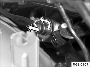

Removing the bulb holder I tried to remove the bulb it won’t budge and I don’t want to use excess pressure in case I break the bulb.
Any ideas? Help!!!!

Z3 Headlamp bulb TIS says turn and pry it out.

Mine are HB3 and HB4, to remove them they rotate about 30 degrees and then just pull out. There are no clips holding them in, it's a bayonet type connector.
Perhaps a photo of the back of your headlight may help us to help you.

Mine are H7 I rotated the holder removed it and pulled the connecting plug of. The bulb won’t come out the holder. Do I need to buy another bulb holder£55 each !!!!
Pictures would help. You can see it, we can't.
H7s are normally held in with a wire clip arrangement which you unhook then just remove the bulb. You do not rotate a H7, in fact you cant due to the locating lugs on the base of the bulb. We definitely need a piccy;)
