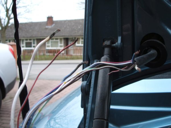

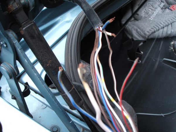

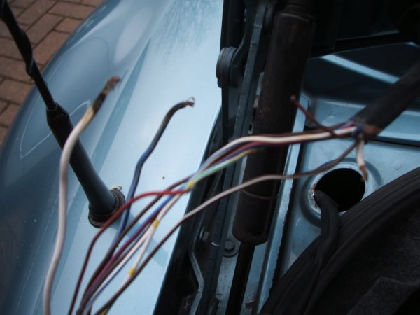

si can i just say that mine looked fine but it did end up being the boot loom.
the wires brake inside the plastic....it may well be its fine but keep this in mind

99% sure thats a loom problem Duncan...Would get it checked ASAP as you can see I was really concerned when I saw the state of the wires, could of gone up in a cloud of smoke.
