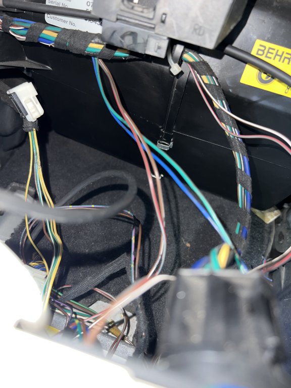

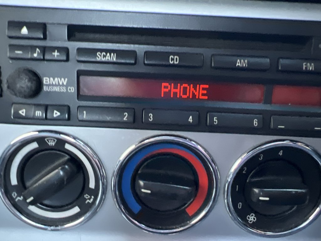

I have ‘Phone’ displayed after switching back to original CD player . Also have a bunch of wires behind that don’t connect to anything , including a lose earth with a clip on the end…. Very puzzling as there’s no other connection required at rear.

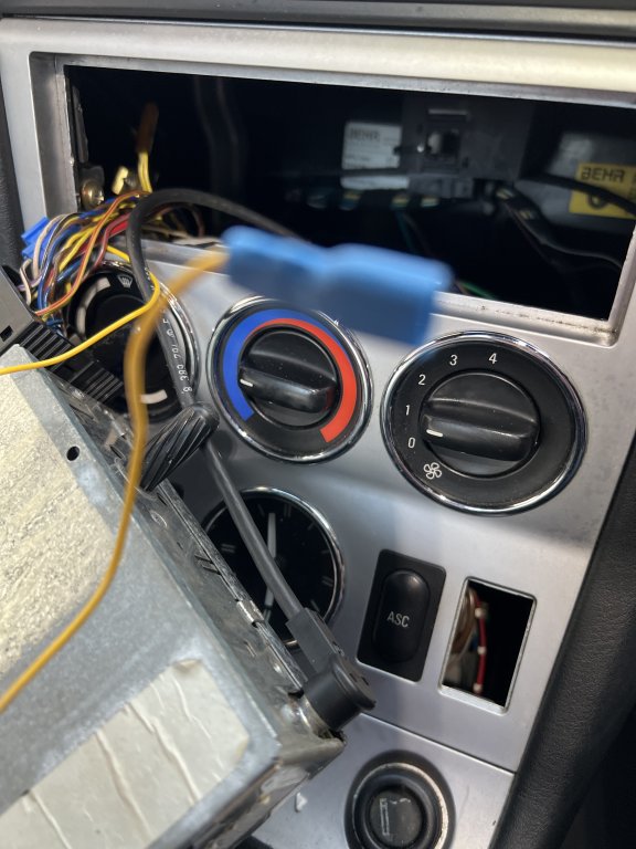

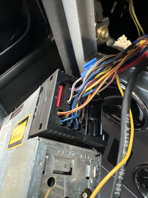

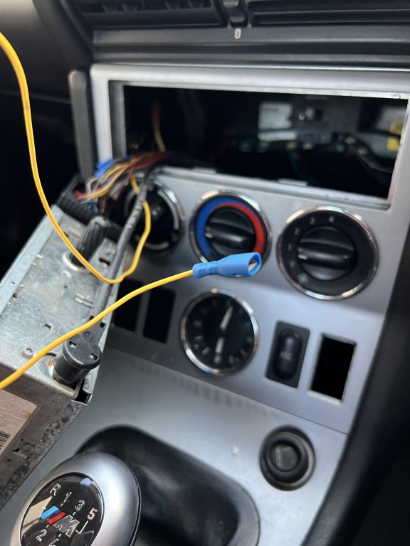

Adding more pictures .. I’m sure the earth needs to go somewhere !

Although ground or earth is usually provided by a dedicated wire in the factory harness it can also be had through the antenna cables shield. This is not to say that a proper ground should not be connected, only that most radios also acquire ground/earth through the antenna shield. This is why your radio is still functional.
Professional installers that are working on large audio systems may play with the grounds to solve noise problems, this is however not usually necessary with a factory or aftermarket radio only situation.
