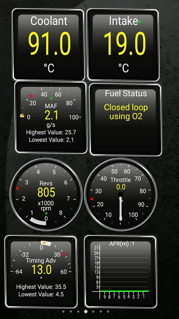

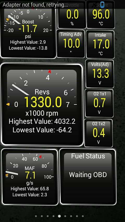

I use the torque app and a bluetooth elm327 adaptor permanently situated under bonnet, plugged into the 20 pin diagnostic port i picked up a switched live on the 20 pin port so the elm 327 bluetooth is not powered all the time... my old android phone stuck on a poundland sticky windscreen mount picks up the bluetooth from unerbonnet with no problem, and the torque app gives me loads of guages and graphs to monitor
i can get true engine temperature, maf sensor intake air temperature, throttle position, vacuum at throttle body front and rear 02 sensors, fuel trims engine load, and also get the live data gps speed, vehicle speed engine rpm, probably loads of other things i have forgot too.. well worth trying the torque app...

Spot on, that's what I use on mine with the dongle permanently in, it even shows boost pressure and water temp, two gauges I would like permanently in my car. I also have an ultrasound which is a standalone unit that plugs into the OBD port, on my zed it finds sixty odd parameters plus it finds and clears fault codes, I also have the ultrasound blue which is just a plug and displays all the parameters onto your done or tablet.
I gotta admit though for around 10 Audi you can't do better than torque.
