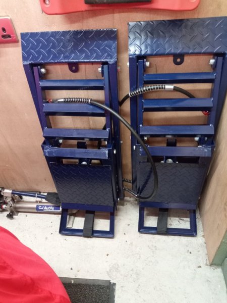

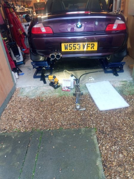

i have just bought a pair of hydraulic car ramps from C J Autos lift car with foot pump and are mobile look them up on you tube you will need extension loaders for the front of the z3
hope this helps
