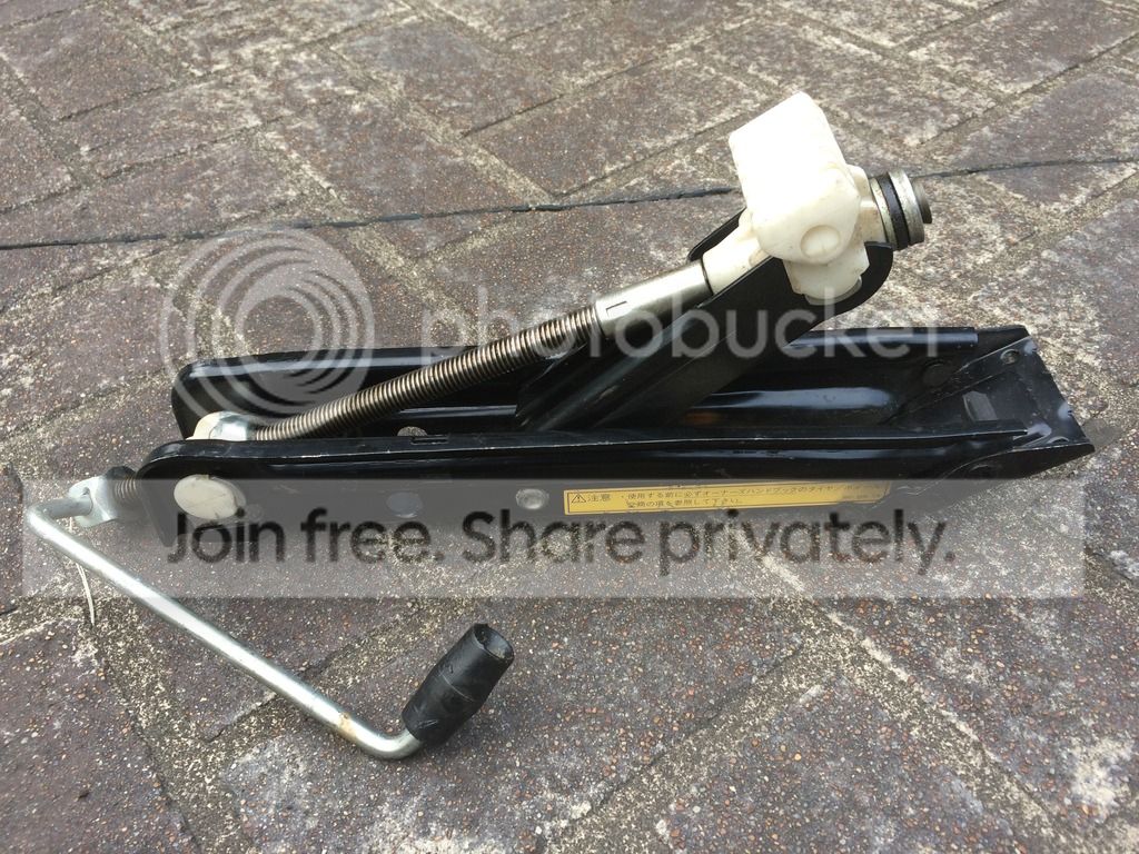

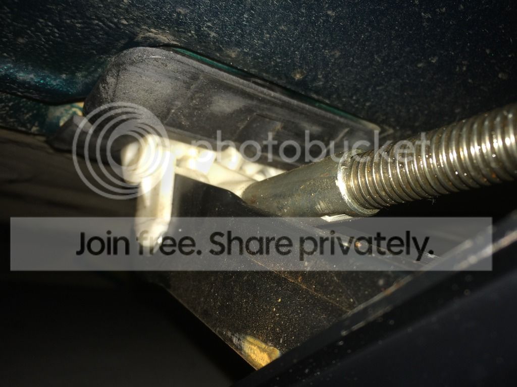

Yes it can, I use a trolley jack with a block of wood cut to fit exactly as the one shown in the picture. My concern would be that when jacked up those jacks are very unstable, so use an axle stand underneath if you intend to work underneath the car.
