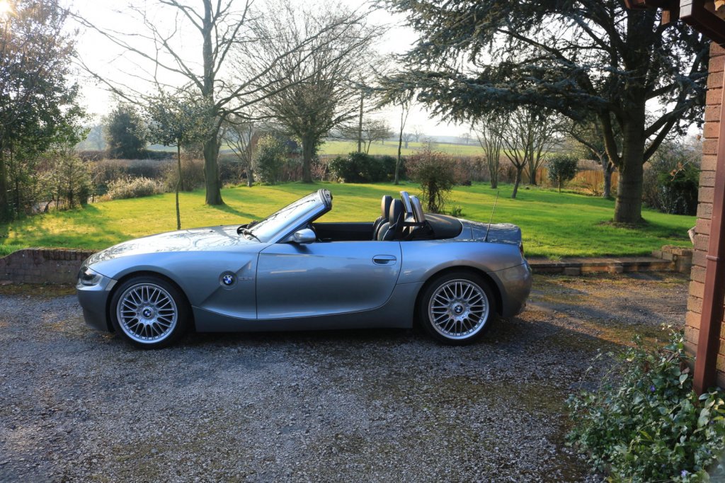

Not sure which Alloys they are, can not see why not these 18" Alpina wheels are fitted on a 3.0 E85
Sorry these are AC Scnitzer

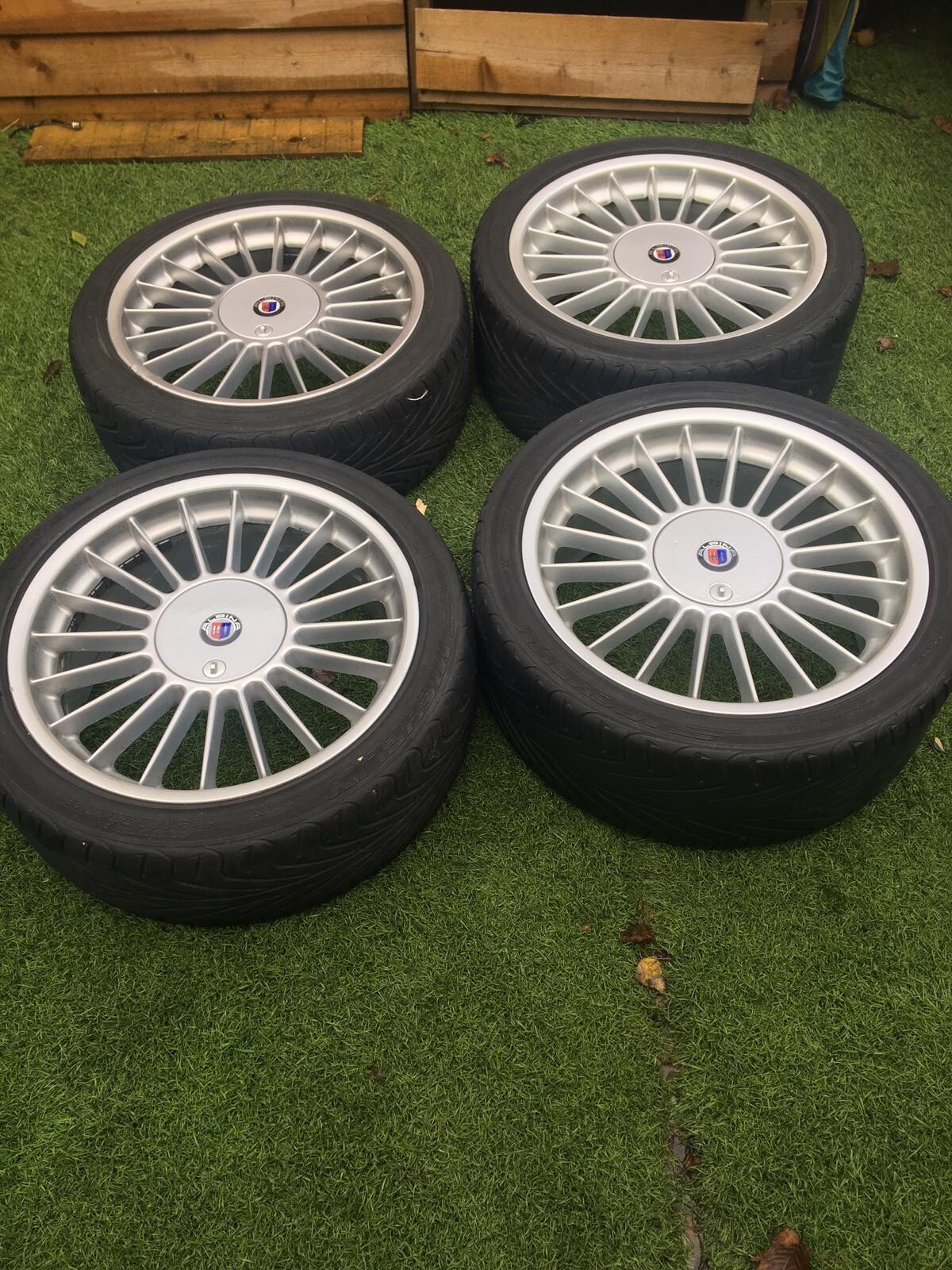

According to the site, it seems they are 5mm and 20mm closer to the strut, which means I might need a spacer for the rears, as the Alpina wheels seem to be 8J all round
These are the Alpina wheels I am wanting to fit,

Post the offsets which should be stamped on the insides of existing alloys and Alpina alloys.

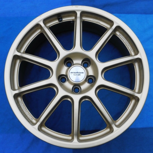

I really like love these type of multi-spoke wheels and if I can't get a set of Alpina's , I was thinking about using these as a possible option. I would guess they are going to be pretty easy to get at a good price, if the offset is workable. I would have to most likely get them refinished in white, so it might end up not working out as any better value for money.
