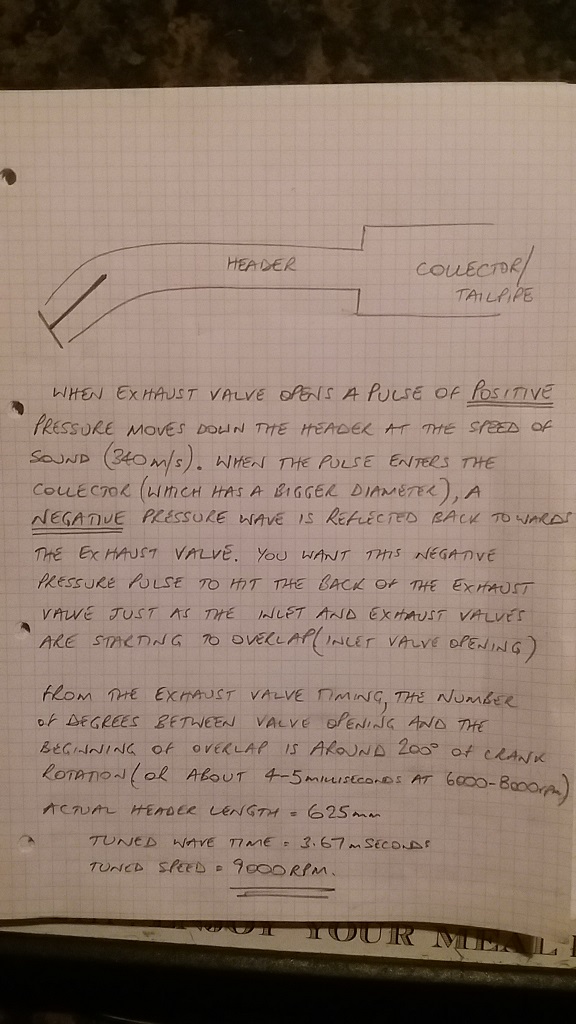

Back pressure causes a high pressure zone.
I've done a lot of work on this subject and the headers on the M (a supposedly tuned engine) should be around a metre long, but are actually more like half a metre. The collector should be much longer than it is, and the tailpipe is cut to suit the length of the car.
In short, I wouldn't worry about throwing away the restrictive catalytic converter if I could. If anything, the cat probably just confuses the reversion waves into a "mushy noise".
