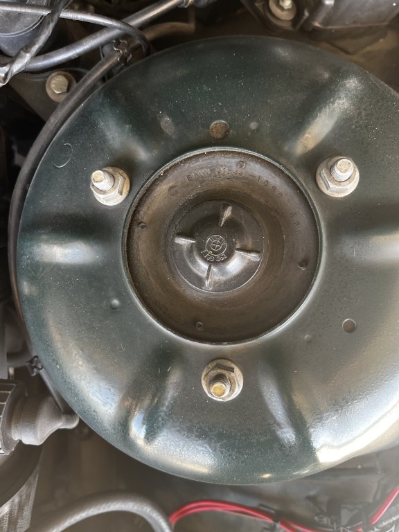

Last weekend, I replaced my control arms and tie rods and fitted Powerflex bushings with new lollipop brackets.
When I took the car for alignment I discovered that my left wheel (driver side) camber is off at -1deg. 29 min.
The previous owner (I have all the history), has replaced the front suspension and top mounts in 2021, but I can see the arrows point in different directions:
According to the Bentley manual, 3.0i Z3 w/o sport suspension should have a -44' camber.
Could the alignment of the arrows cause this difference? As far as I know, the 2001 3.0i has no offset on the top mounts, but it's the only thing I can see pointing in completely different directions...
Let me know if you have any ideas...
Cheers!
