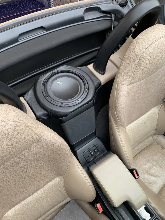

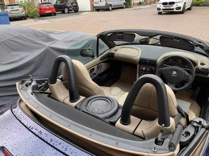

So it was a fairly wet day today and the misses b******* off with her friends and that left me some time to ‘tinker’ :D

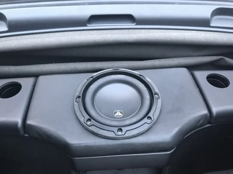

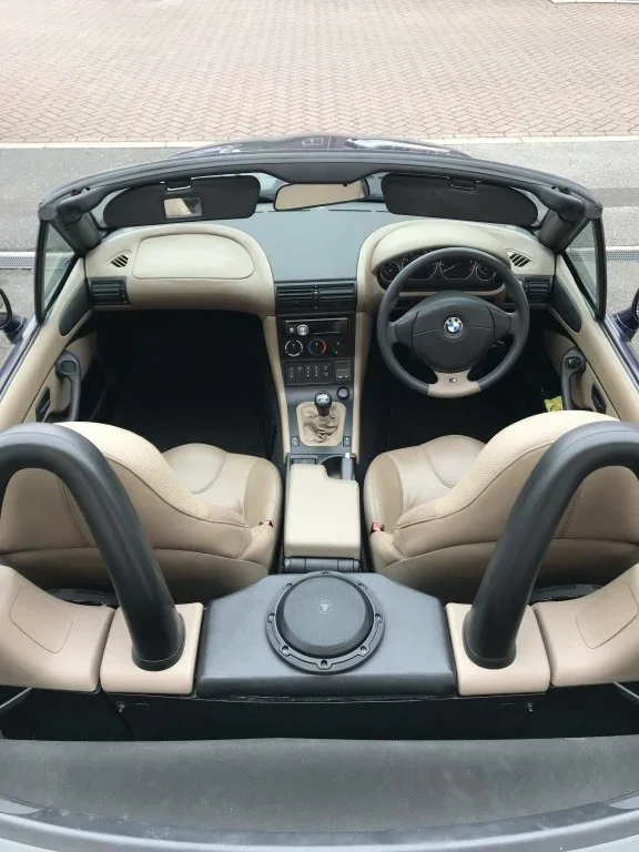

I previously made a sub enclosure utilising the space between the roll hoops and used a JL Audio 6w3v3 sub. It’s good and very happy with it, but as I have 2 Zeds it just meant swapping it between them both - as I’ve upgraded the audio in both.
54EC096A-9C8E-4907-86A0-A2436B33CBB4.jpeg BB821091-45AD-402D-A960-5F126FA71A53.jpeg E967B1C7-A4EA-46BB-80A4-BC9E45A2D700.jpeg DC8D5118-613F-4C0F-8783-C92C6D81B185.jpeg

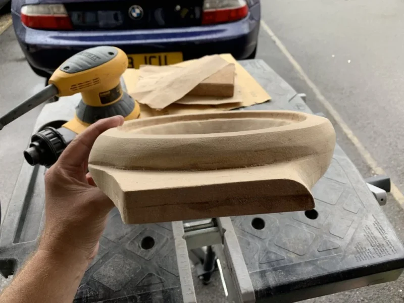

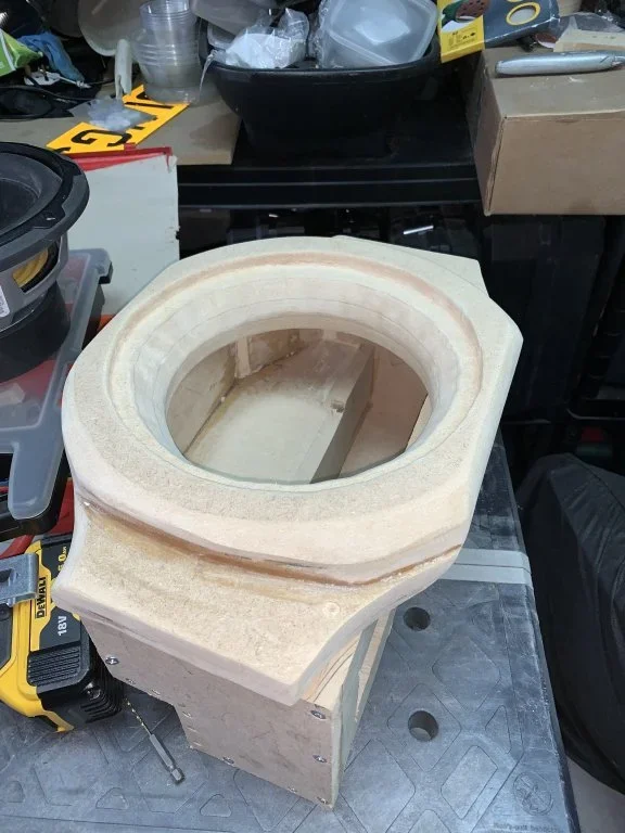

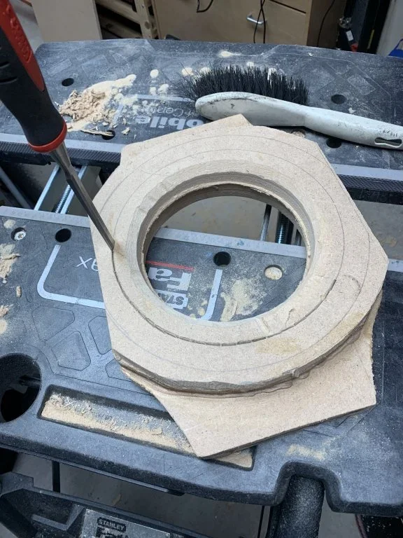

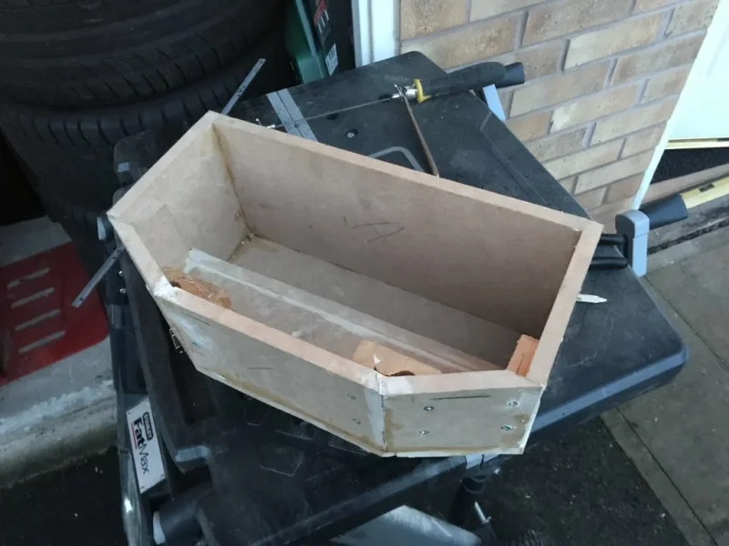

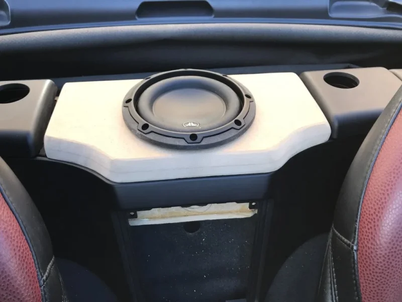

So around Xmas I found sourced a JL audio 8w3v3 sub, which I thought I could fit. I started to build another enclosure and then left the project as the depth of the 8” sub was too much, and I needed time to consider options.

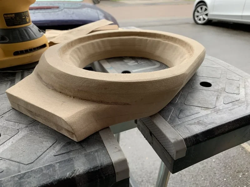

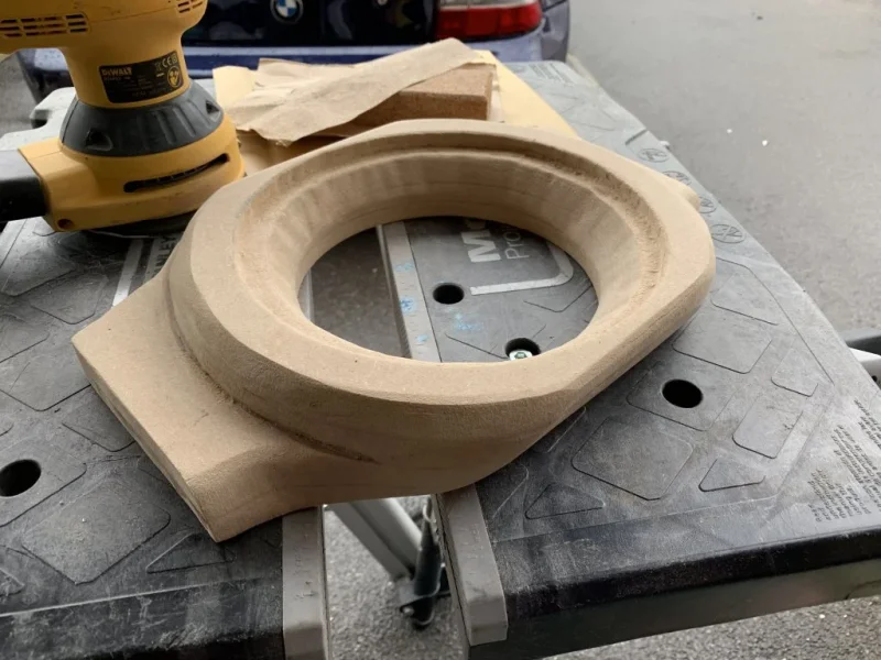

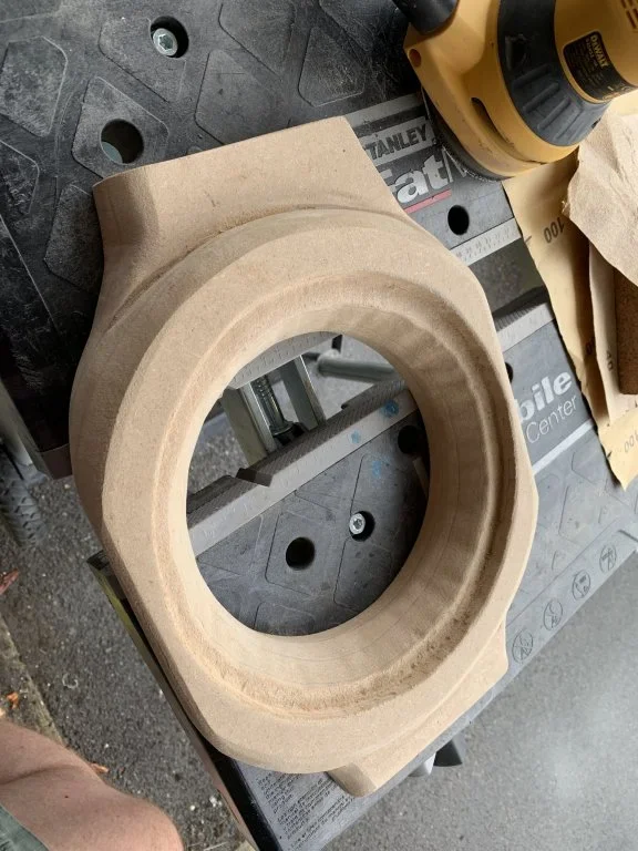

Well I had to enlarge the mounting lid, both in terms of width and height. I had fun shaping the lid with my orbital sander.
B96A1CEB-3B3D-41D8-8FA4-4627879E67A8.jpeg FDEBBF8F-7C6A-4C58-86BF-0C2D8F34DA88.jpeg 5473D8EE-3416-44CC-AC78-6652AA16FE92.jpeg 2F52B450-2173-4CD9-8C97-B8BD08B2AF17.jpeg FD91CBBA-56CD-412D-B56E-7AB558853EF2.jpeg 5F458351-A445-428A-96E7-44003C7FB168.jpeg 7CE3B28D-6CA1-4130-AF6C-44555CD958EC.jpeg

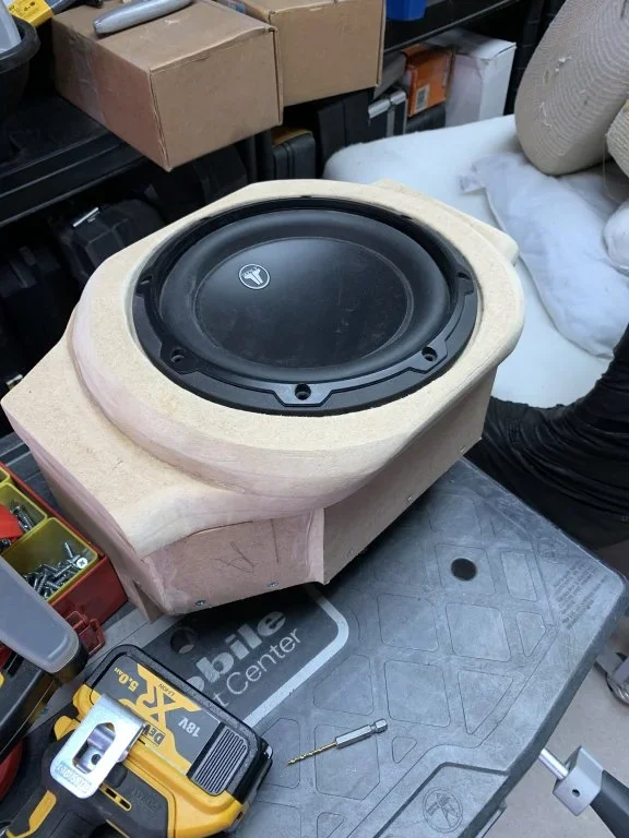

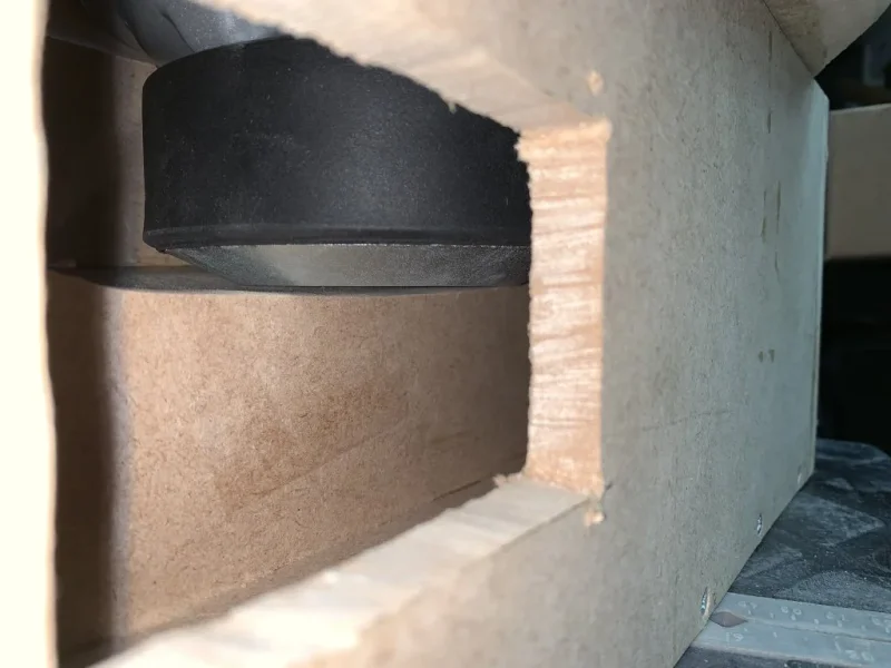

Test fit:
Ohhhh not much room at the bottom of the magnet :eek:

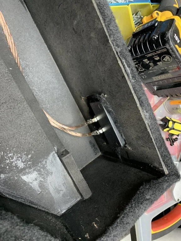

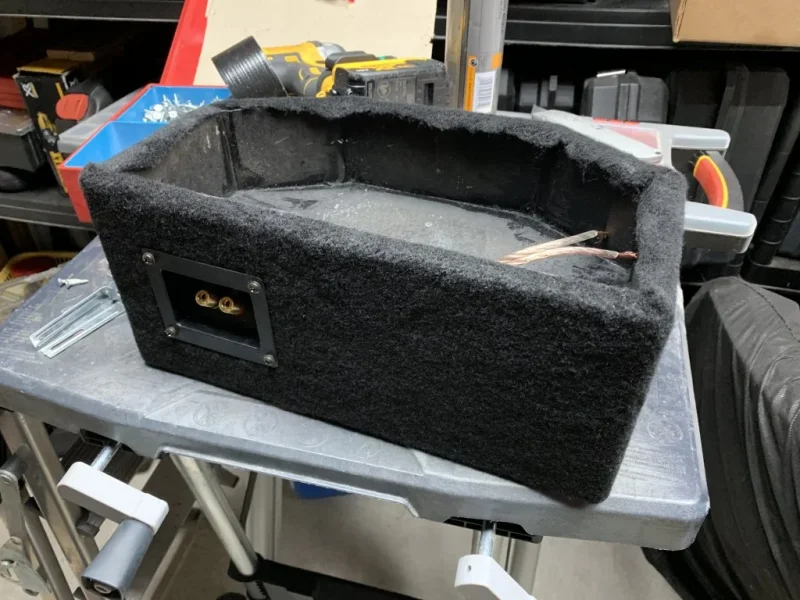

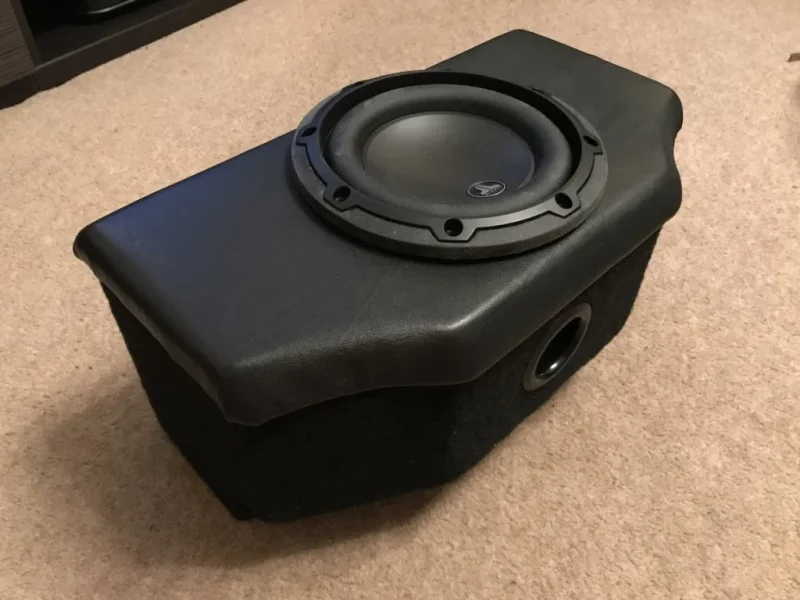

The enclosure I gave the inside a quick rattle can of satin black and then covered with acoustic carpet.
5DBB76C4-7CB4-49BB-9AF9-C9E623AAE506.jpeg 7CE3489F-E484-4D05-BDE9-E1CD1390DBC9.jpeg

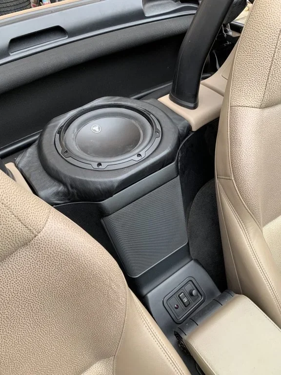

The lid I covered in some black leather.
Quite happy with the end result.
72E7673B-2091-4E38-8A8D-68EED3EDF4BB.jpeg B138331E-89D2-4635-A003-524D8CBDFF1B.jpeg BBD1F9A9-95CB-4F52-B6FF-684EF47AA9B9.jpeg
Just got to order a sub mesh grill and all sorted :thumbsup:
Now both my Zeds have a sub each at last!
