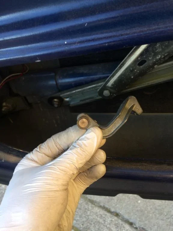

Hi, I just bought a z3 and the drivers door isnt opening from the outside. Can anyone help me with that? anyone know what this piece is supposed to be attached to?

Not the best of picture, but I can't see the bit you have in your hand as part of the door lock mechanism itself.

hmm i think its just the handle problem and not the lock mechanism because it still opens from the inside.

To me the part in your hand has snapped of the door handle mechanism.
If you get hold of a new door handle then you should be able to swap over the lock as to keep the same keys.
