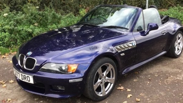

Hi all.
Just taken the plunge with a Z3 2.8 and first job is to replace the brake calipers discs and pads. Any suggestions for anything else I should do at the same time would be appreciated, brake pipes etc?
Had a look online and there is such a choice and huge price differences too.
Any suggestions as to a good setup, I don't mind cost if quality is good. Don't really want to pay just for the name.
Thanks
