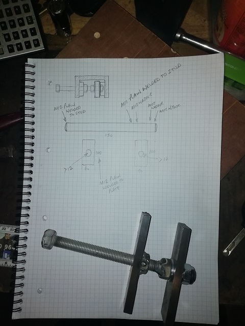

More scrap metal put to good use... a tool for pushing the brake piston back into the caliper.
Pingu Zorg Guru (III) 3rd Party Trader Joined Dec 8, 2011 Points 145 Dec 12, 2018 #1 More scrap metal put to good use... a tool for pushing the brake piston back into the caliper.
