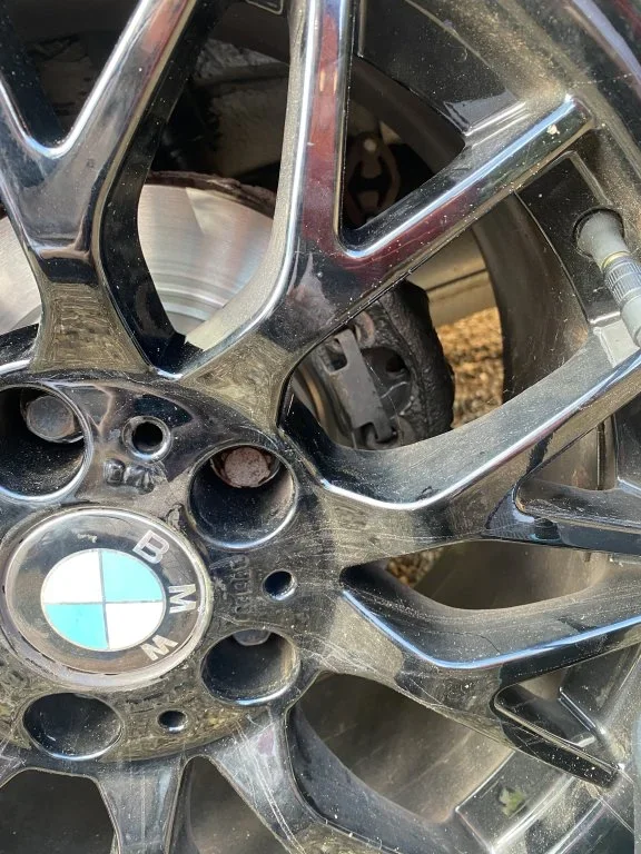

Hi everyone
I got a MoT advisory about ‘Nearside Rear Brake pad(s) wearing thin inner and outer pads - caliper noted as binding slightly’. The brake pads were very thin indeed and I ordered new ‘Eicher Premium Brake Pad (Rear)’. When I was going to replace the pads I noticed that the pads on the Offside were still quite thick. I managed to remove them after some bending, but the new pads did not get into place. They are thicker than the old ones and I can’t get both of them into place. May they be too thick or am I doing something wrong?
I think I need to replace at least one of the calipers, the one that was binding slightly. Do you think I need to replace the other one too since the pads on that side looked rarely used?
Sounds as though the calliper piston is not pushed fully in and looking at the slider pins that would confirm it. With the piston pushed fully in you should not be able to see the shiny part of the slider pin. You may well find that the side where the pads are stick quite thick the piston is also sticking slightly.
Thanks Tony. I think both callipers are quite rotten so will probably buy new ones.

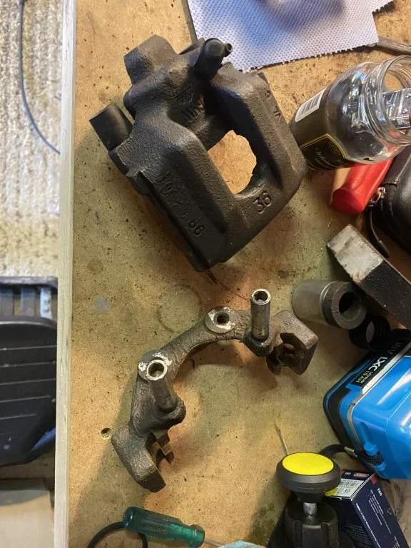

Mine are not that bad. Should be fine to refurb. If I can figure out how to remove the piston without compressed air…
I changed calipers on a Volvo recenty. On that, if the brake pedal was engaged, no brake fluid came out from the hose. Is it the same with the Z3 or do I need to clamp the hose closed?
Use a stick or similar to hold the brake pedal down about halfway, the fluid cannot run out of the reservoir. Avoid clamping rubber hoses if possible on any car.
Simples. Undo the slider pins, lift the caliper off, and pump the pedal till the piston's just about out, then either clamp the hose or jam the pedal a bit down. One at a time is probably best, but both can be done at the same time given enough clamps. I've done them by myself in the past, but it'll help if you've got some form of assistant. Changing the seals is easy, and just how far you go with cleaning the body and covering it with some nice lairy paint is up to you. That BiggRed place isn't the only one to do kits, have a google around. And if you do cock things up you can always give up and send them away.:whistle:

Thank you. That was a very good tip. The pistons pretty much jumped out of the calipers. Ordered parts now and will hopefully have the car off the jack stands the coming weekend. :D

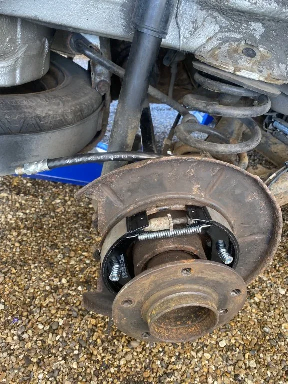

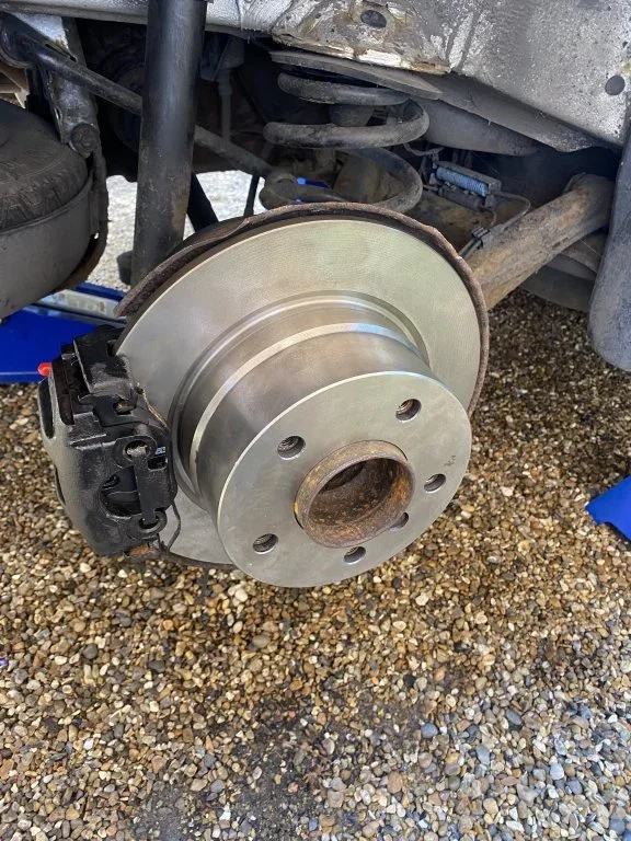

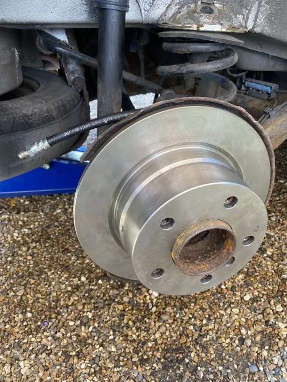

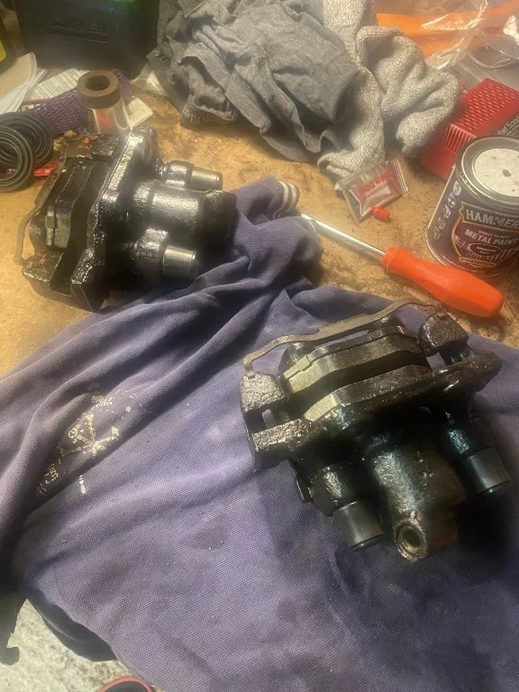

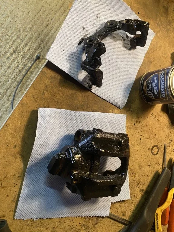

Finally done! The project grew a bit. I meant to just replace the rear pads and one caliper, but it ended with two refurbished and painted calipers, new discs and handbrake shoes too. 😅
