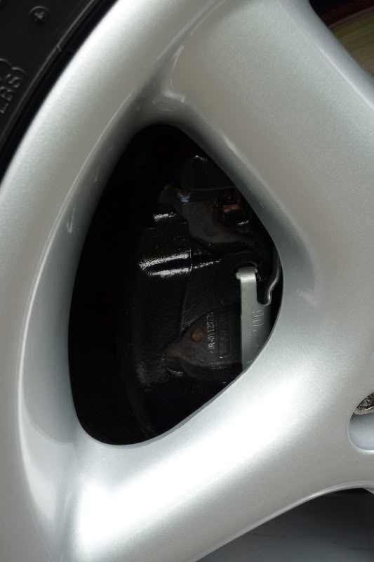

I used E-Tech Caliper Paint on my Zed a couple of years ago. You will find it advertised on eBay. It comes in a kit complete with a can of brake cleaner which is essential to degrease the callipers before application of the paint. As you can see, it gave an excellent finish, but prepping the callipers was hard work as I stripped them off the car and wire brushed them and gave them a going over with an air powered needle gun. I also treated them to a set of new anti-rattle springs to complete the effect.
I have used Smoothrite before, but found it very difficult to get a good finish as it dries almost as soon as its applied. As far as colour is concerned, the choice is yours. I went for black on my Boston Green Zed as I didn't want to make it look like a Max Power car, but red on silver would be okay, I think.
