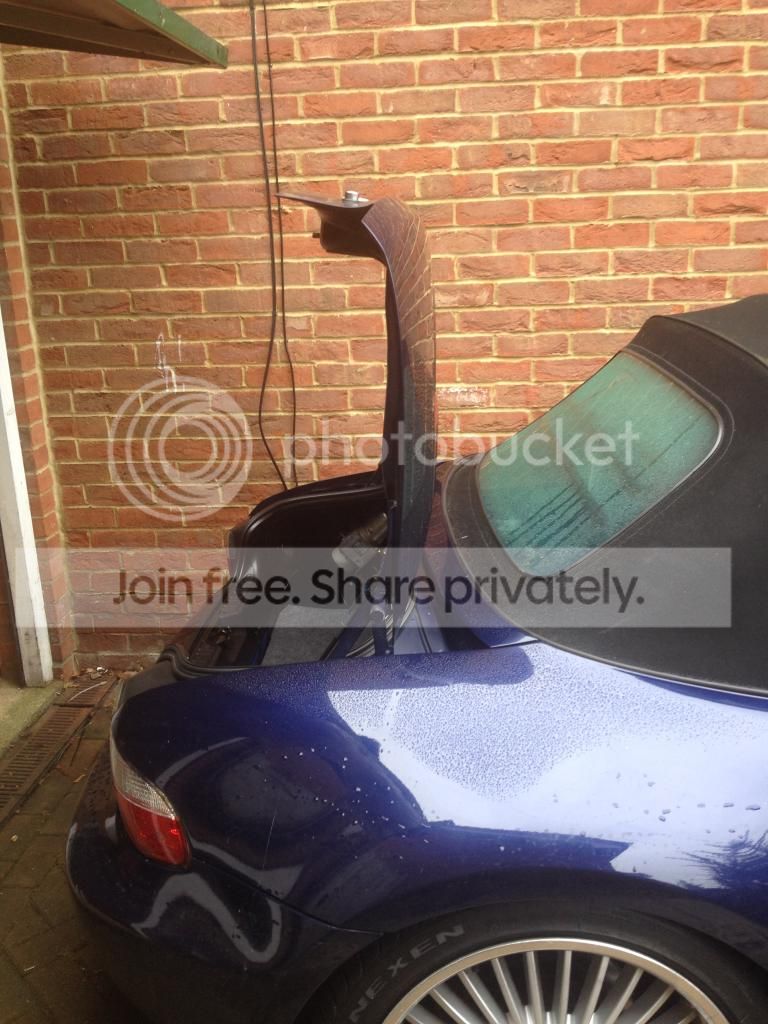

    I was working in the boot today and must have pushed it open a bit too far - a loud bang followed by the boot opening to a full 90degree angle.
    Looking at the bootlid open full I thought, finally the boot opens properly like it should!
    [​IMG]
    I thought that maybe there was something blocking my boot hinges all along and I dislodged it.
    On further inspection all was ok on the hinges so I tested the boot lock and realized the cable in there has snapped/dislodged.
    So I have made sure not to let the boot shut fully until I can strip out the lock and investigate further.
    The only info I have found on the net so far says that once a Z boot lock fails there is no way to open it so making sure it doesn't close fully!
    I'll report back once I've stripped it out but was wondering how far does everyone else's boot lids open. I like the new 90degree angle it's opening at now and would like to keep it that way...

    I can't really see the connection between the boot lid angle and the release cable which is attached to the catch, unless it has stretched near one of the hinges. I had the boot lid catch off my car last year and it was a little bit fiddly but easy enough.

    They should all open like this to 90 degrees.

    That's what leads me to think the cable has been stretched by fouling one of the hinges. Mine opens to that amount and after a wash when I open the boot to wipe round the edges water runs from the outside of the brake light on the boot lid.

    Good to know they all should open like that...

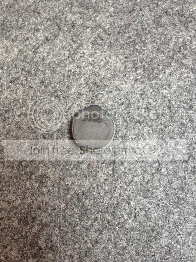

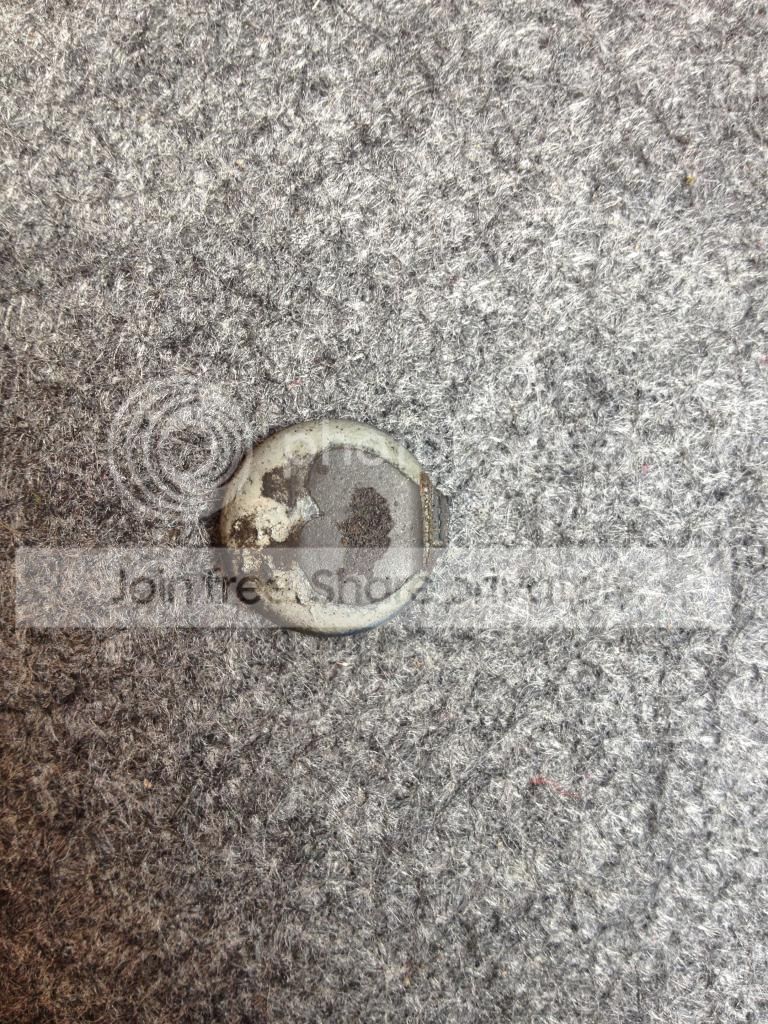

    So I managed to have a good look today. The cables are all intact and boot lock works fine.
    I found the something that was rattling around in the boot lock area and after maneuvering the boot with the brake light inside cover off this little grommet fell out - it seems that it was somewhere blocking the opening somehow (it has a ridge mark from being squashed).
    So not a cable or connector rod as I thought.
    [​IMG]
    [​IMG]
    Boot opens fine now but as mentioned needs help to get fully open as struts probably tired (or just by design?).
    One of the strut lower 'ball joint' mounting point is cracked so has some play but still attached and functions fine...
