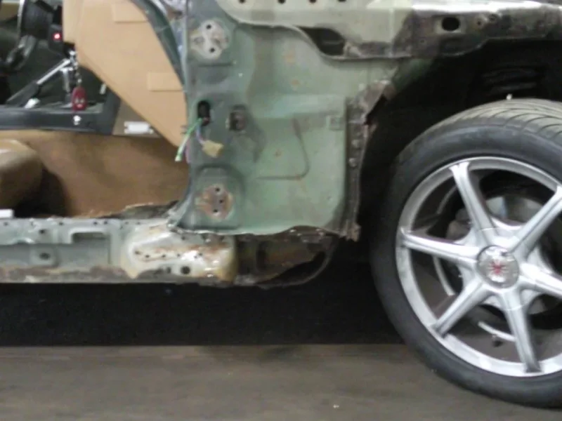

I followed the procedure to remove the side sills on my silver Z3, and found my sills were pretty rotten. By the time I had the paint bead blasted off, all I was left with was some holey scrap metal. :(

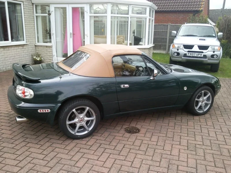

Tony do you have a picture of your eyebrows ?
Yes I do. Painted and fitted myself, very easy to fit with 3M double sided tape. Been on 2 years now and still well stuck.

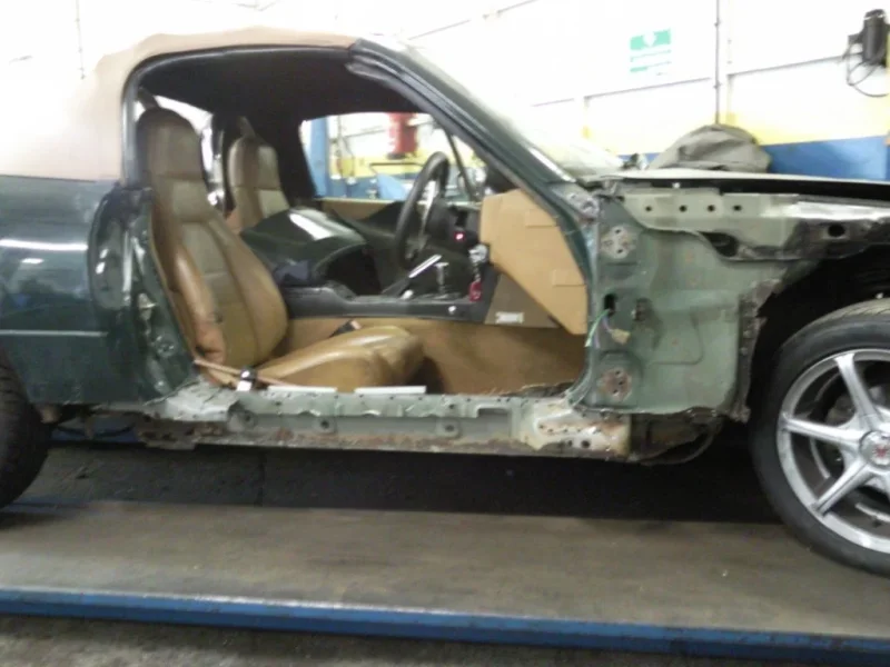

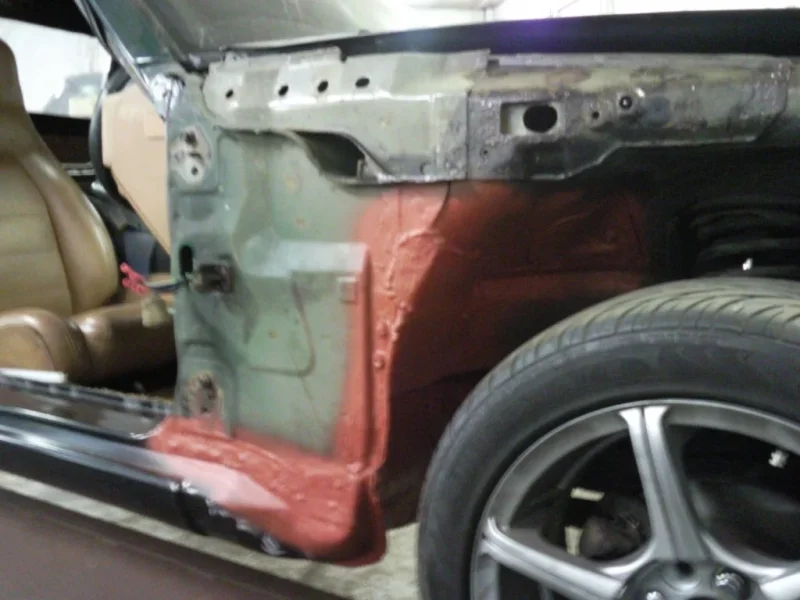

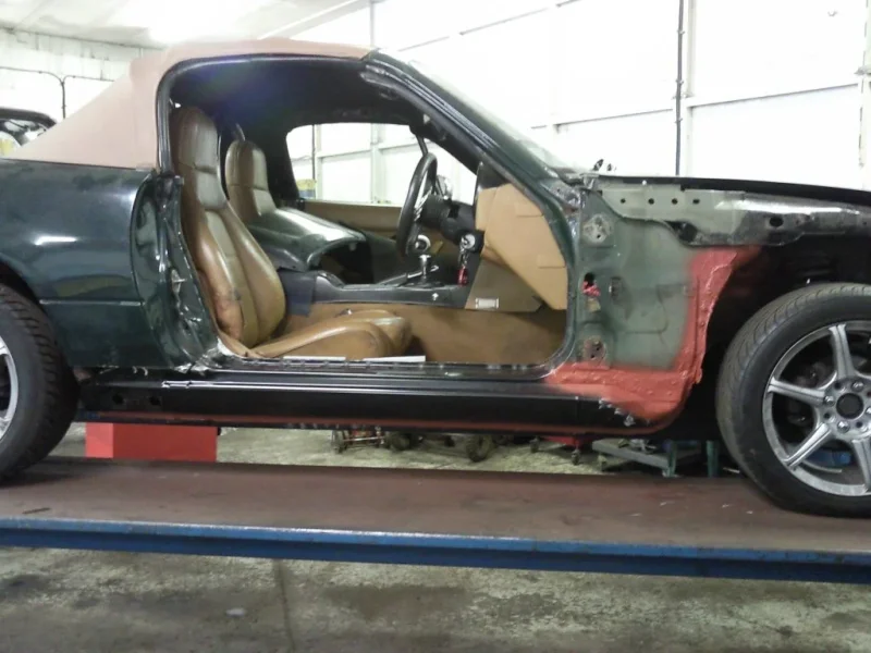

Re body work, a few years ago before the Z I had a real hairdressers car, a Mazda Eunos. I started doing some repairs to the drivers sill/floor area and this is how it went.
