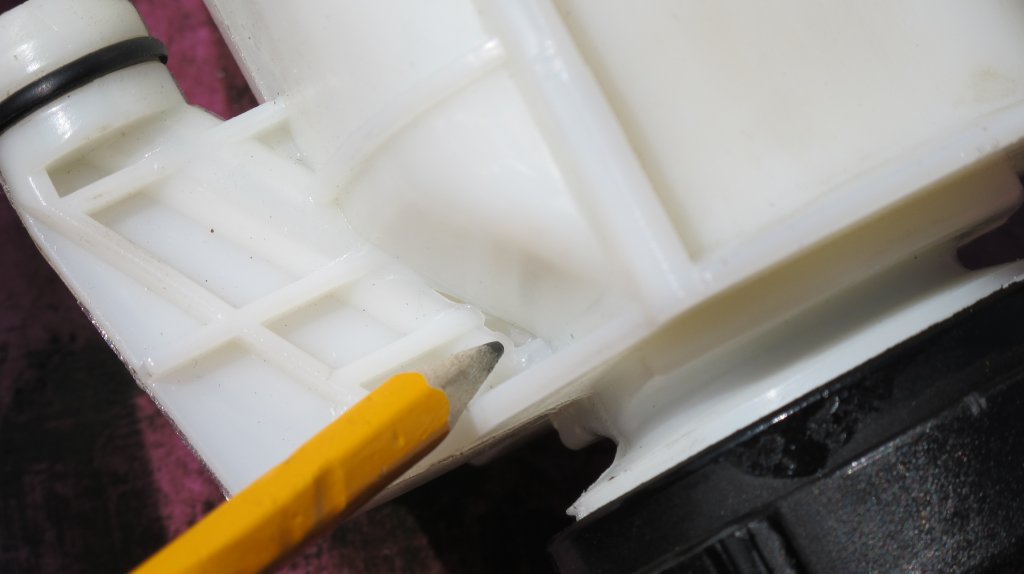

Everything went nice (no swearing) and smooth like in a Pelican or TIS description and the surprise was that despite of all estimations the water pump was in a great condition (I still have tears in my eyes
! like loosing a good friend) and the famous plastic brackets of the thermostat were in position!
The engine it's looking great, no corrosion......
When opening the packing box of the Bugatti water pump , purchased from Ebay, surprise
With more tears into my eyes, this time swearing included too
, I ordered a Ruville water pump:
So the myths regarding water pump life time max 100 000 km (mine 171 000 km and still great shape!) and breakage of the plastic brackets of the thermostat aren't always true! Myth Busted! Maybe the engine was never overheated and always with quality antifreeze or it's just the God of mechanics smiling sometimes......
But the thermostat was faulty; I have seen how the new one works after running the engine.
Conclusion: I love the M44!
